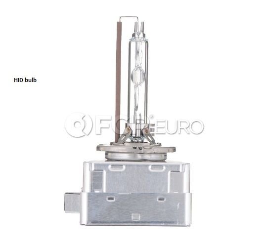

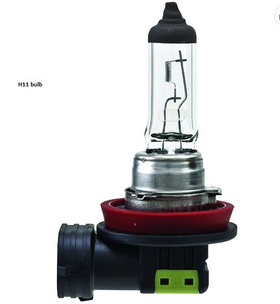

What bulbs do you have? Halogen or HID were offered. Halogen (H11 or H7) is an incandescent bulb, and has a filament - no ballast or igniter needed. The bulb connectors typically melt on those. The HID bulbs have no filament - like a fluorescent bulb and need a ballast to make the voltage high enough to make gasses in the bulb illuminate without a filament.

Thanks for the info. Apparently, my lights are Halogen (H11 bulb). I have replaced the H11 bulb and all of the low beam fuses I can find. Still no low beam on driver's side. I guess I have to look at the more esoteric solutions. My understanding is there is no low beam relay. If you know otherwise, please let me know. Thank you for the information, I appreciate your valuable response.
