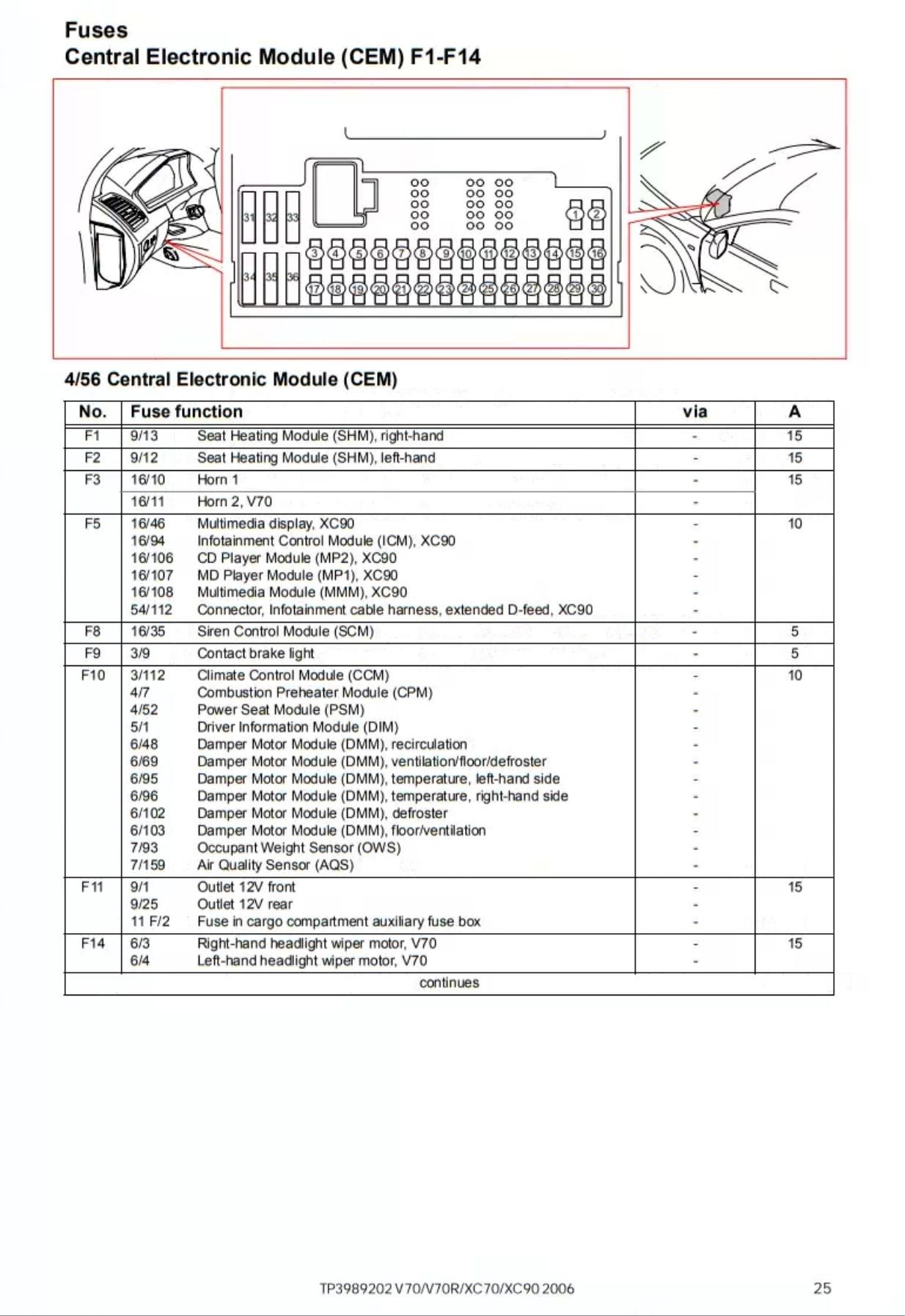

Here's one - there is no brake light relay, power comes directly from the REM. Does the 3rd brakelight work? Are there any codes stored in the CEm or REM related to lighting? 3/9 is the brake light switch.

appreciate that diagram Hoonk .

Do you have 12v at fuse f9 on the CEM? (that sends power to the switch)
