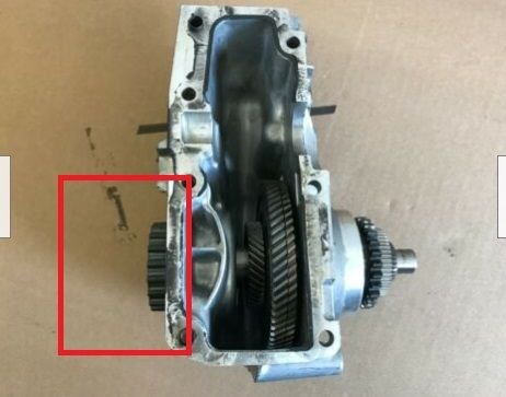

Shown below is an "alternator decoupler" and the alternator coupling. Coupling goes between the alternator one way clutch and the gear you see on the READ assembly. The alternator one way clutch is not going to get damaged by the READ "dancing around in there".
When the one way clutch/decoupler/OAP/overrun clutch goes bad - they usually seize. Then when the engine slow down quickly, the mass of the alternator spinning pulls the drive gear loose (on the READ side) and the alternator stops being driven, it no longer spins and the battery goes dead while driving.
This stuff does not break very often and you will find very few that have experience with it. You might want to learn as much as you can - before buying stuff you don't need, or trusting your engine to someone who does not have the skills or the tools to repair your car. For READ info - check this guys website https://www.volvoread.com/the-volvo-read-page/
