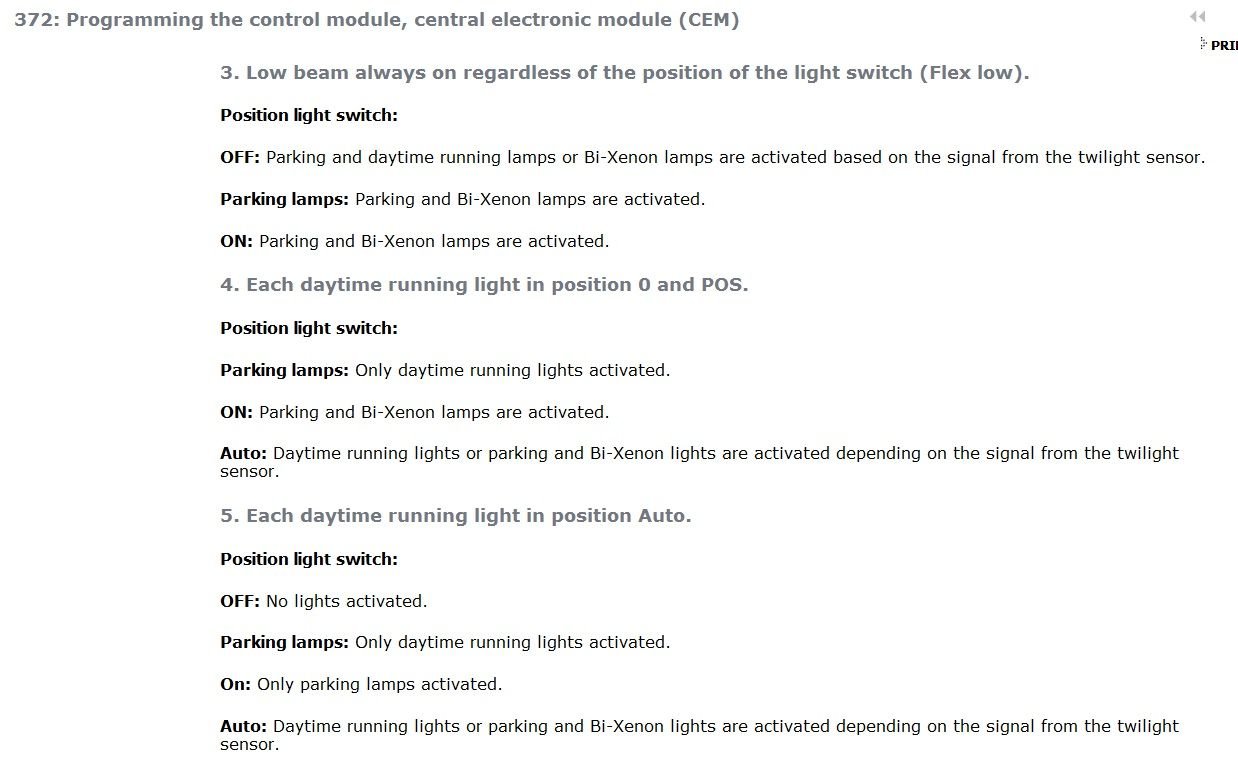

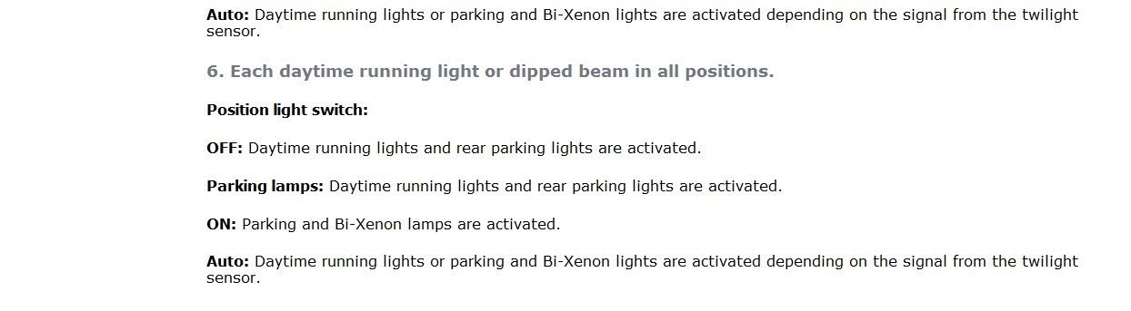

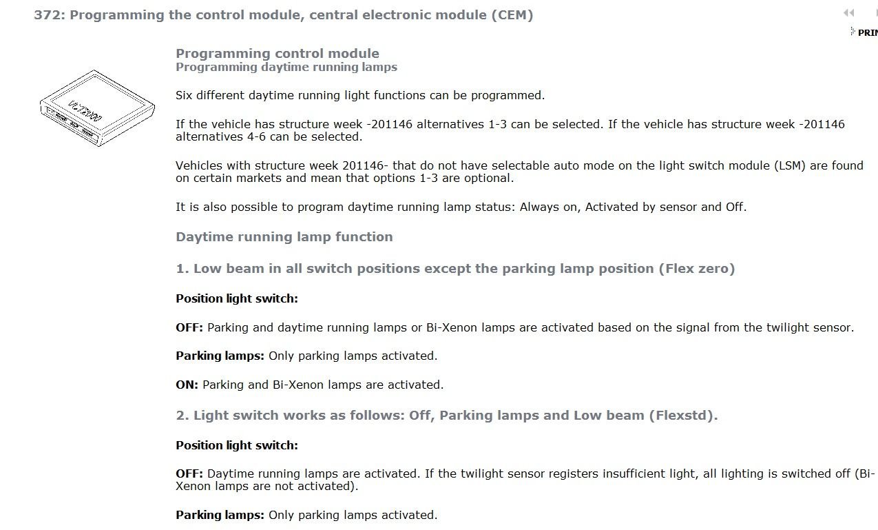

By default your headlamps are on all the time. (on most of the cars) You can change that to make the bulbs last longer. (on most Volvos) Another problem (with the H11 bulbs) is melted connections at the bulb. The original plastic connectors have been upgraded to ones (hopefully) less likely to melt at the bulb connection. Changing the daytime running lamp function requires Vida and a dice unit or compatible interface. It can be done without a subscription using the easy to find for free Vida version 2014d. Expensive scan tools (shop level) might be able to do this also.
