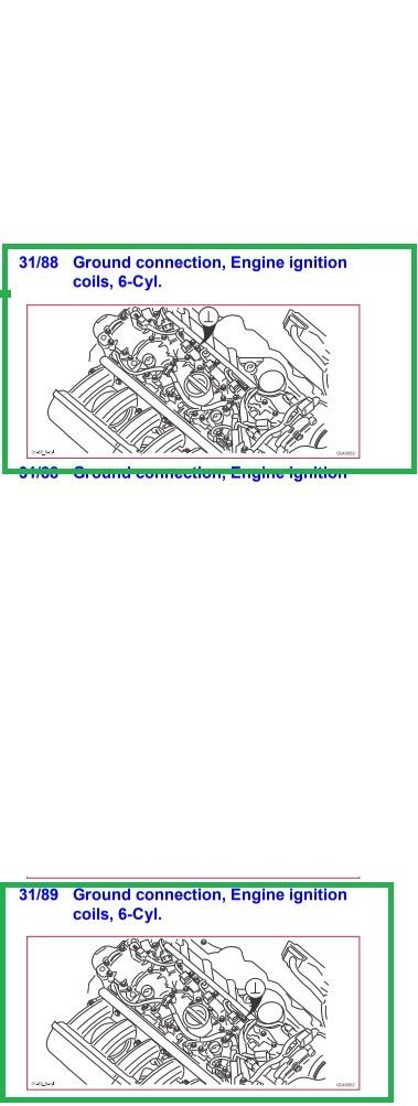

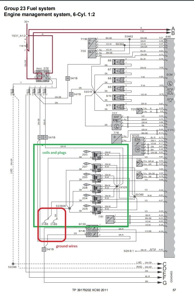

Note in the wiring diagram below #1 and #5 (or #6 and #2) use a different ground wire for the coils than the other 4 cylinders.

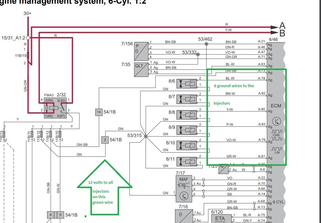

All the injectors (8/6-8/11) get +12 volts from the green wire as shown in the wiring diagram. The injectors are grounded by the ECM. If you have +12 volts at the green wire on each injector - you could check continuity on the 6 wires injector grounding wires going to the ECM.
