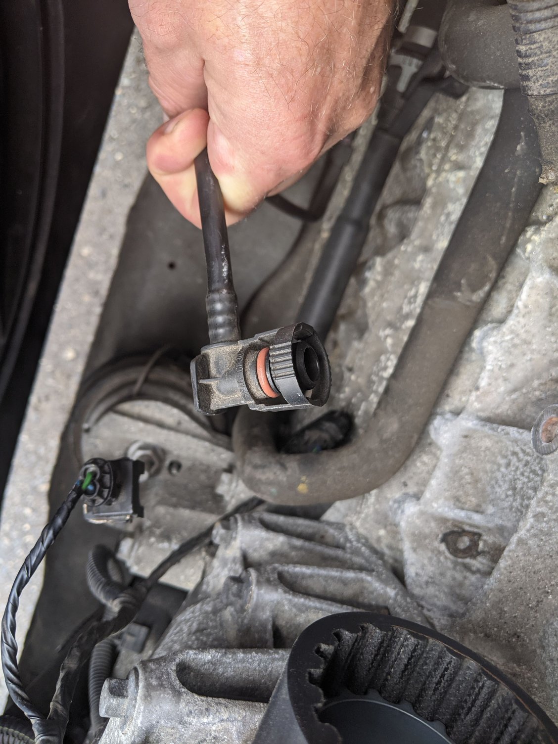

Replacing an XC90 alternator and could use some help with what i think is the fuel vapor recovery hose. Anyone know the proper way to disconnect/ connect this line? Picture is attached. Thanks for the help.

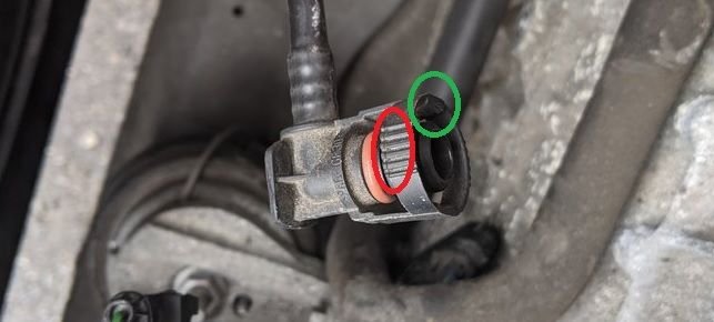

Squeeze the red areas, the green latches lease, pull straight off - then push back on.
