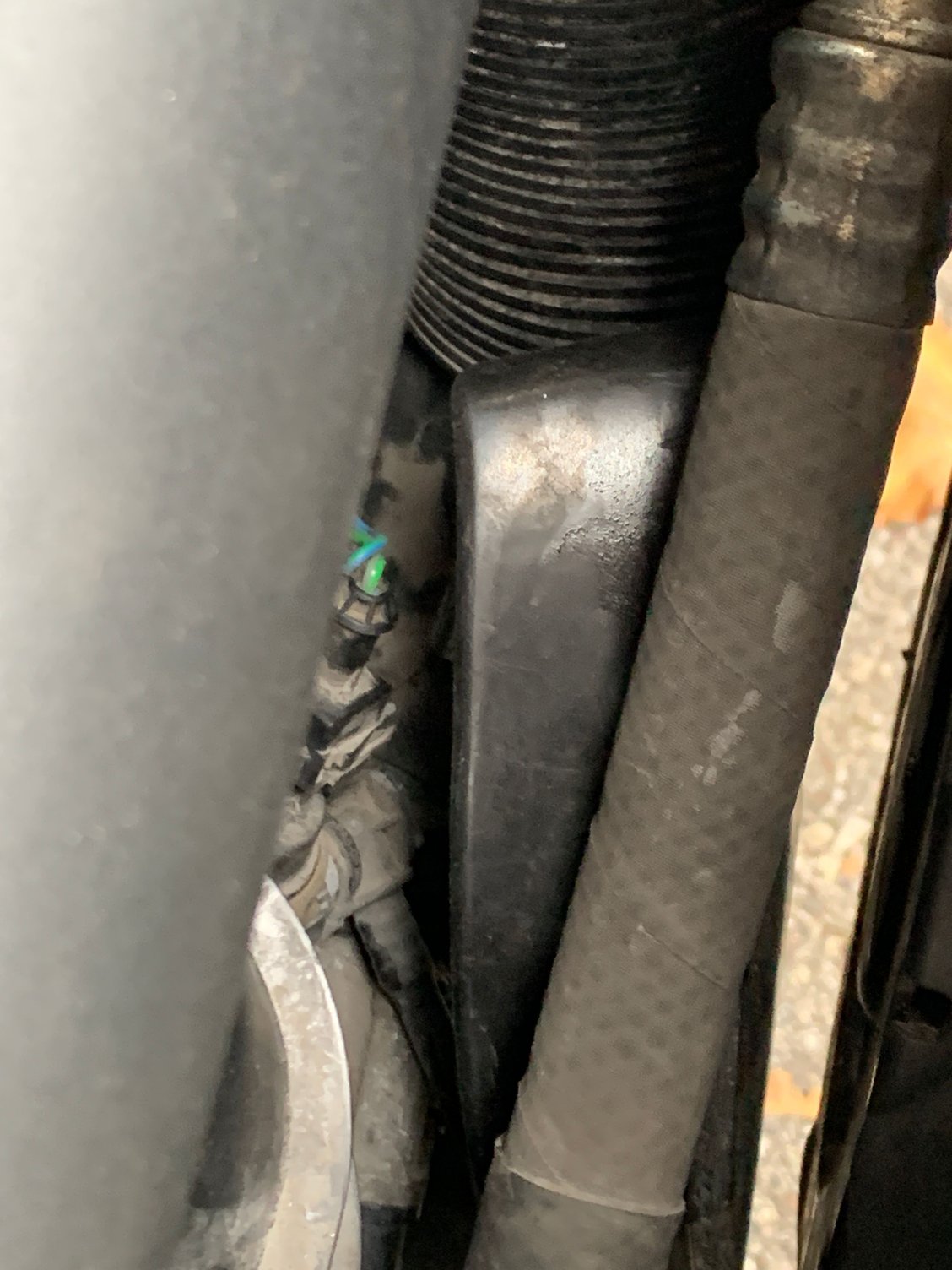

Update: In the process of removing the throttle body in order to clean it, I discovered that the resonator on the intake tube was very loose and not completely seated into the tube, in fact, it was so loose it was bouncing around and I’m surprised that it didn’t fall off. Apparently, someone had it apart at some point and didn’t reinstall it properly. The resulting effect was unmetered air entering the engine which caused the bogging condition. The item I’m referring to is a black plastic triangular shaped part directly below the A/C hose in the picture.
