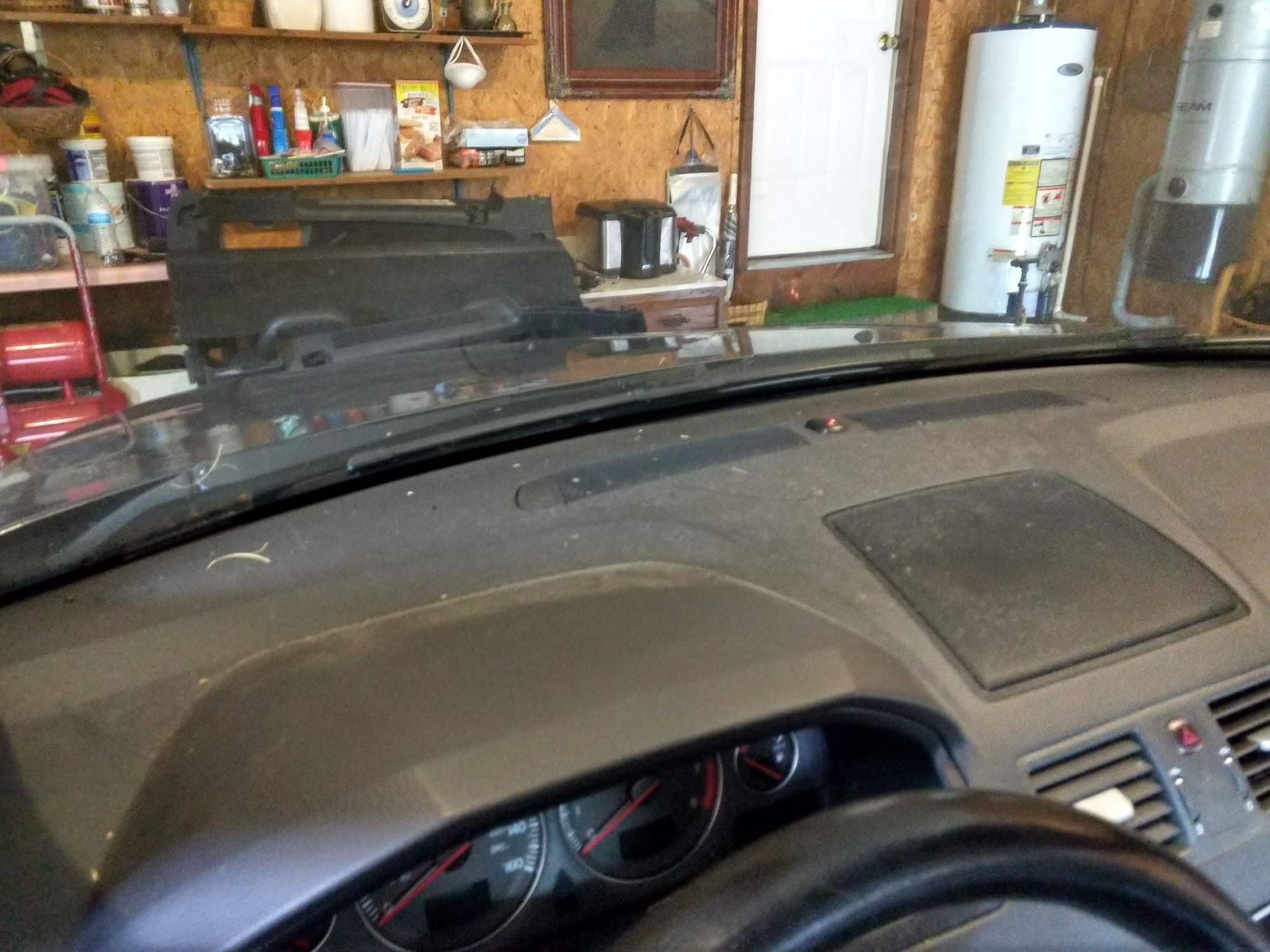

Started work in the 2005 Volvo. Its a real mess. Was able to drive it home 45 miles with 2 inches of water above the carpets. The Anti Skid unit underwater. Hope to grab the one out of thats parts truck. Anyways I was able to start drying it out, Got 90 % of the water out and did a repair to both sunroof drains as shown in the pictures. Both had shrunk from heat and where a whole 2 inches away from the rubber 90 angles. both had of course been dumper all rain right into the truck all summer. I got some plastic tube that the originals fit in and then used clear silicon to attach them and seal up where they pass into the drain of the a pillar. rained all week and no more water inside from it

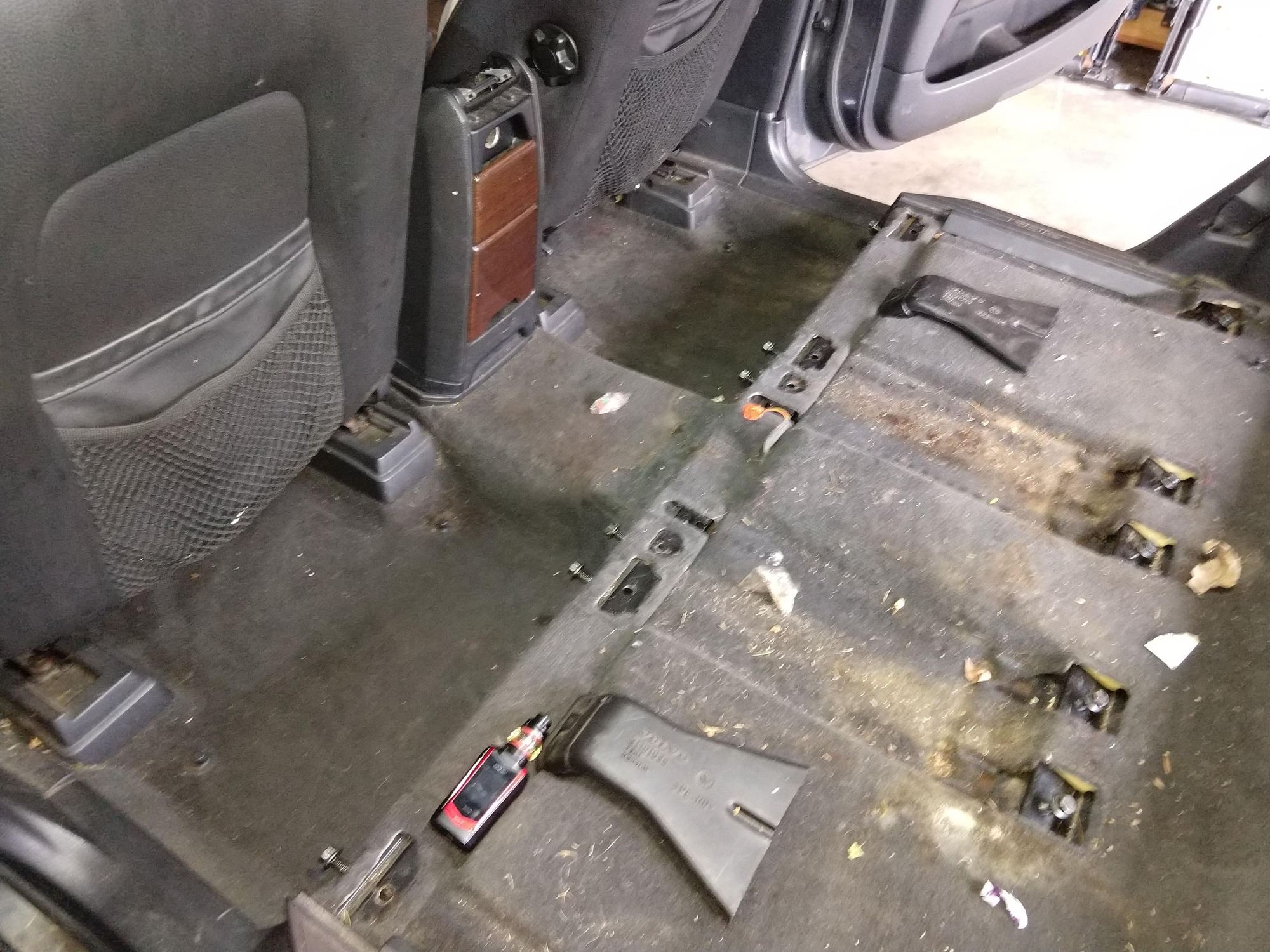

Today I was able to remove all the seats, side panels etc in prep for pulling out the carpet and matting both can be saved with a good shampoo and drying I think and a good soak in some anti mold solution there was mold growing in the rear carpets.
Also replaced the rear wiper motor and arm, and the rear door hatch handle with parts for the donor both like new and working great now. Getting the 3rd row out was a little bit of a job
Learning as I go here, working on getting the center column out now.
Carpet all out took all day but was able to use wet dry to suck remaining water. The carpets where bone dry but I got 4.5 gallons out of it not including what's trapped in the foam padding. everything sitting outside to dry then the cleaning/repair begins. not a bad days work.

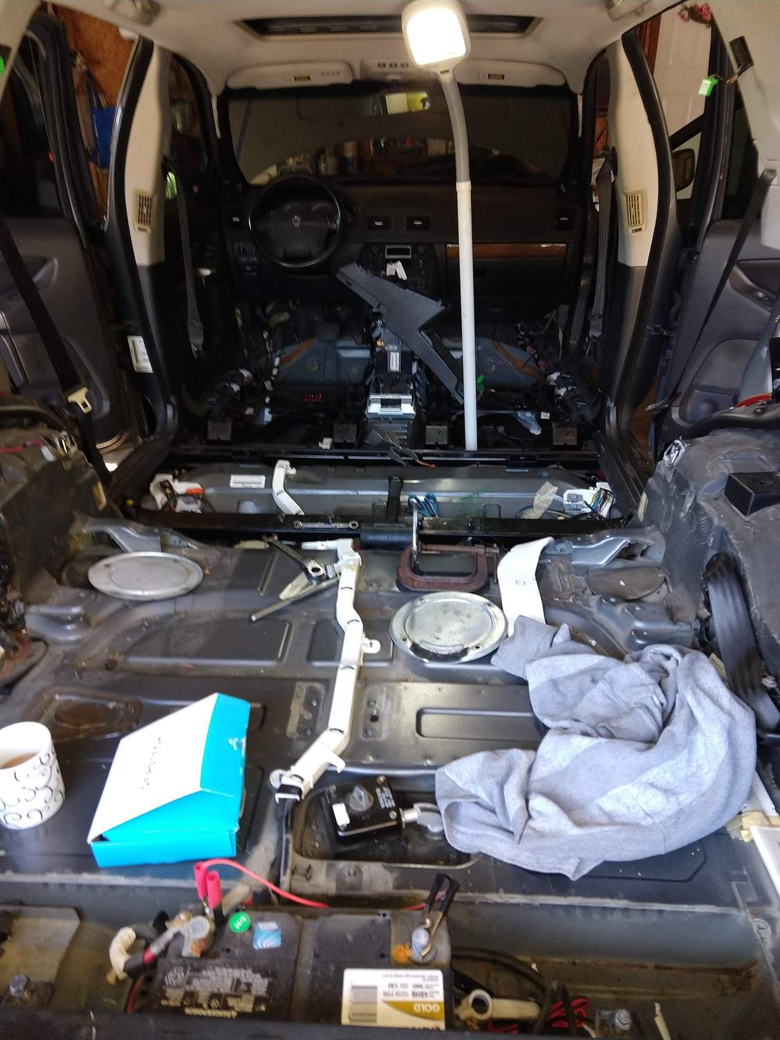

More today, Waiting on tool to remove fuel pump ring. Took off the fuel filter and cut it open only to find it clean. I was told that this tank was full of rust This fuel filter has 300 miles on it and not a speck in it. Still going to pull out the fuel pump and endoscope tank. Maybe lager crap in there..
Took all carpet and parts out and gave everything a good power washing and shampoo. aside from a few small stains, it looks almost new and the smells all gone. Only a the front parts dried enough to put back in but the front is all but back together sans seats.

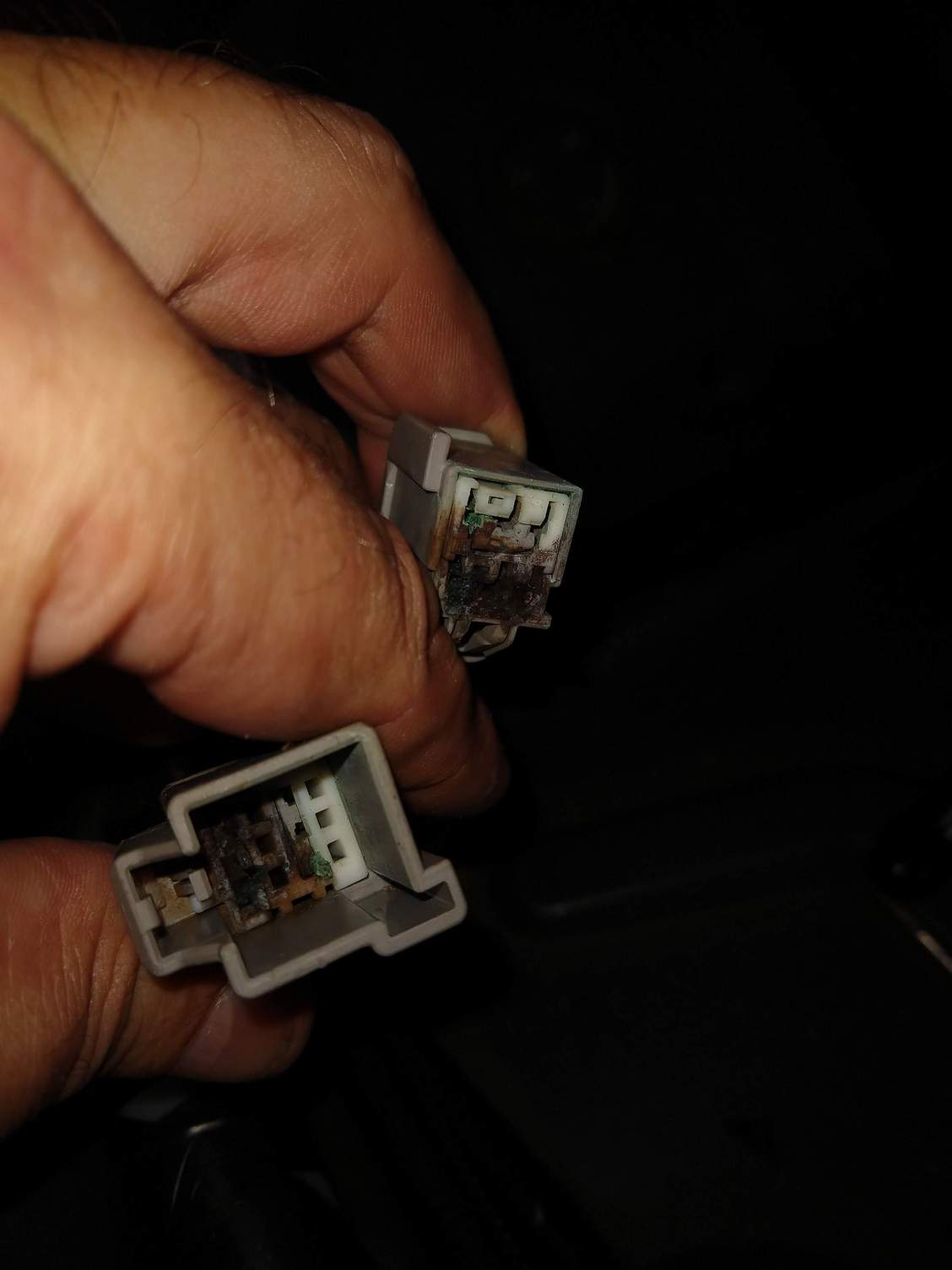

Check a wire connector the was below water line and sure enough it was burnt inside. from outside it looked fine have soldered the wires and water proofed.

Thats where I'm at waiting on the spanner to show up tomorrow so I can pull the fuel pump and endoscope the tank. Since that fuel filter was so clean I have high home. Everything from dash to rear seats is back in

location of burnt connector
If anyone could tell me what the burnt plug is for. it was in the drivers side kick panel at floor height and it's part of the wire loom that runs down the floor to the rear. If can get a picture of it better to show location if thats hard to read. It the only connector there.

That connector is for the leak detection pump.

Thank You!!
That would explain the CEL. once I figure out what fuel pump I need to order to replace the current one and get the power back on, it will be interesting to see if that will clear.
