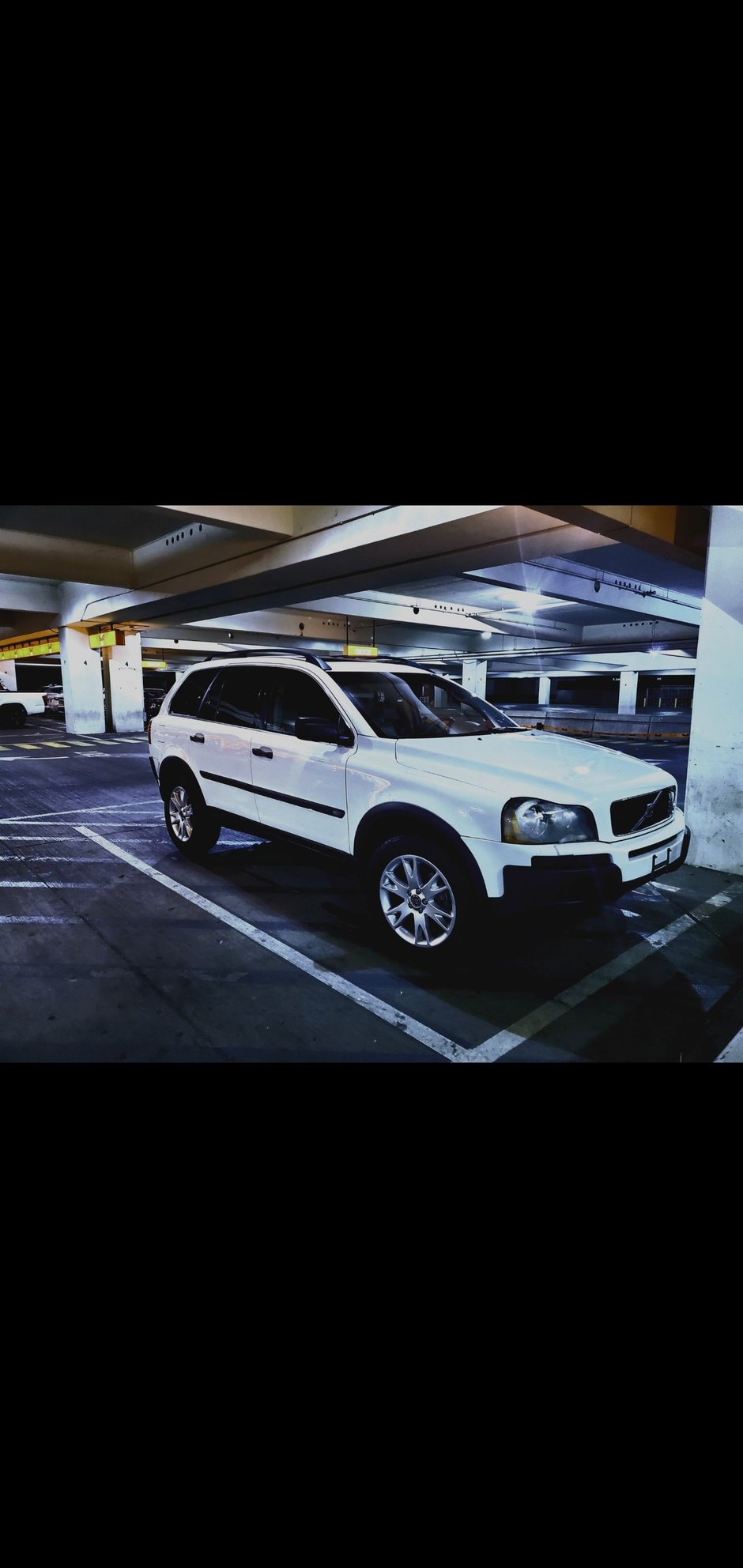

Guys I really want to do something to this XC90 that I wish at the time I knew to get the V8 R but it's too late I want to get it nice exhaust something that gives it that hemi sound like is it even possible to upgrade my turbo and for my engine to handle it at 159,000 mi like what suggestions do you enthusiast have to start with to beef this up cuz basically I just got a real clean looking 05 XC90 with LED lights LED fog lights and I'm even looking into doing the LED bar for the upper tail lights but finding anything for the 2.5 t all-wheel drive seems impossible seems like everything I look at is for the V8 hell I even spent $300 on one of those touch screen Android radios that you replace with the speaker grill on top of the dash only to find out that my radio doesn't have the main power plug so I can't even add an aux cord let alone a touch screen radio I'm eventually in the market for a V70 or XC90 type r but for right now I want to beef
She's clean but needs some beef on them bones
this up
