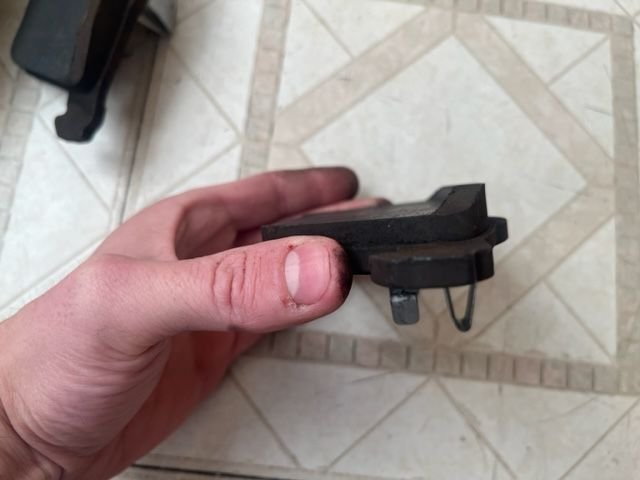

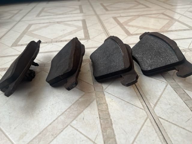

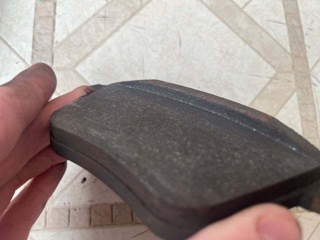

I just bought my XC90 3 months ago and just got around to replacing the front brake pads. After removing the old ones, I noticed something odd about the wear pattern. For some context, I've always owned Japanese cars prior to this (mostly Hondas and Acuras), and I've never seen worn out brakes like these. They developed a pretty big '"lip" on the outer edge, kind of like if the edge of the brake never touched the rotor itself. The reason for changing the brake pads was that they were squealing when it was cold out (under 5 degrees Celsius). After driving around for 10-15 minutes, the squealing while braking went away. Anyways, see pictures below.

Correct - either the rotors or the pads are incorrect. If the pads fit properly i'd bet someone put the smaller rotors on. I'll search for a picture of the 3 sizes.

I think the last owner put the wrong pads on it. The rotors are marked (and I measured) at 316mm. The pads, I assume are 336mm. The picture below shows the lip being around 9mm, which would make sense for 336mm rotors. 336 - 316 = 20mm. 20mm diameter difference means that the radius changes by 10mm, therefore creating that lip on the picture.
Or - how about the wrong rotors?

search the boards for a recent post - it suggested that the different pads use different clip types and provided some pics to match the pad to the rotor size. My suggestion would be to see if you can determine what was original for your model - that may take a call to the dealer with your VIN or build plate info.
