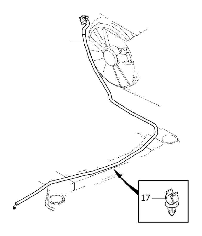

Hey group, Hope this finds everyone well. It’s been a good bit since I’ve posted. I have recently gotten the XC90 back from my daughter permanently. It’s a 2007/3.2/AWD. It threw a P0441 purge valve code just before it was inspection time (of course). So I changed the purge valve, cleared the code and passed inspection. Now it has started setting the P0445 “gross leak” code. I think I mucked up one or both of the hoses going to the valve. I’ve ordered the short rubber hose the goes on the push fit end of the valve to the throttle body from FCP Euro, should be here tomorrow. I want to replace the other that has the squeeze connector with the o-ring. FCP Euro gave me a part number of 31219681 pictured below. They don’t stock them but most all the Volvo dealers web sites show them in stock and they don’t break the bank. Where does the other end go? I’ve looked a bit but it’s not jumping out at me. Anyone change this hose?

Sorry I don’t have an answer to your question. I was wondering if you have the part number for “the short rubber hose the goes on the push fit end of the valve to the throttle body”?
