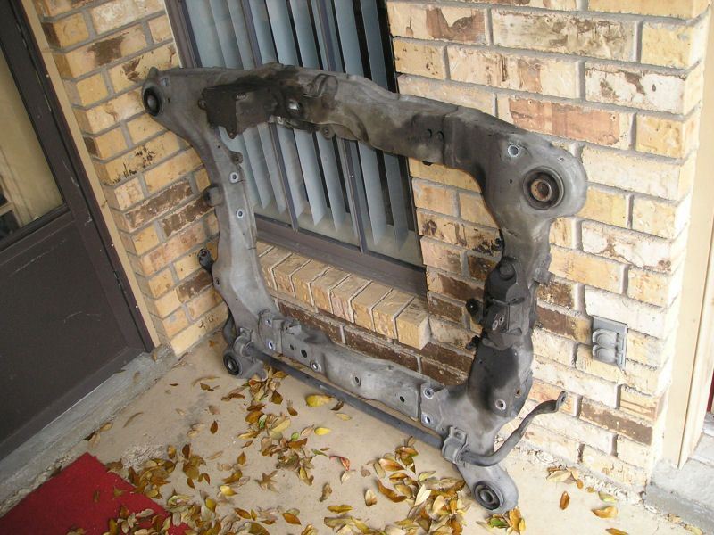

I ended up removing the bar, cutting off the old bushings with a hack saw, cleaning up the area with a wire brush/drill, then installing a poly bushing kit. It's nice and tight now. All that work took place when I had to disassemble the front suspension and drop the engine cradle in order to replace the rear cat/exhaust manifold. But that's another story.
engine cradle with sway bar

Yes you can change just the rubber, but be aware that the oem bars are bonded to the oem bushings. There are many euro parts for makeshift repairs, some work better than others. I don't use many of these aftermarket parts because of the reliability issues and having some bad past experiences with some euro stuff. I've never used these sway bar bushings on oem bars, but I have replaced many oem bars with oem replacement bars and also the Ipd as well as some other bars with their respective kits and had great results.
IPD bushings are meant to be used with ipd bars. This isn't perfectly clear in some of the prior posts. IPD, to my knowledge, doesn't sell bushings to be used with oem bars!!!!! Their kits are well worth the improved performance and are relatively easy to install. The full kit which is what I have used for the front will cost about 499.00 us. You can also get the instructions for their bars at their web site, which are also available at many euro sites, if you can read Swedish, as well. I do believe ipd gets them from some place in Finland.
Where are you going to purchase these Febest parts?
On another side note the ipd bars have welded thrust washers to control the side forces on the bushing mounts. While I applaud the effort I want to know more about the bar used in the pictures? I would have concerns about using hose clamps on a 25 mm bar, could you have taken it some place and welded some split rings on instead? Are the clamps chewing up the poly ?
If the rubber on oem bars is gone I would also take a real hard look at the control arms and the shock bearings as well. Personally I wouldn't ever replace oem assemblys with just some rubber bushings. Personally I think just about every Volvo sway bar is undersized in the first place. Which I suspect is the reason they are BONDED in the first place and the small size they are.
Personally I love my ipd kits, but then again I am absolutely in love with my total poly changeover using Powerflex poly bushings on my S60 and for an experiment I changed over all my bushings to powerflex bushing on my XC70, what an incredible difference in the XC70!!!! The S60 awd shares many of the same parts as the XC70, but no one was doing anything much with their cross country's, what a difference, I just can't get over what a difference changing out all the sway bars and bushings made!!! I think Vivia still can get the powerflex bushings.
AND BTW: anyone who takes off the front sub frame has discovered the joy and ease of doing so, it's really not all that hard and I congratulate your efforts, personally after doing all that work, ( I did notice the new motor mount!!!) I would have gotten the frame powdercoated some bizzare color just to let the world know of your efforts!!! did you change the frame bushings while you were there as well?

I changed: motor mounts, frame bushings, Volvo lower control arms and ball joints, Meyle sway bar links. And no, no chewing up of bushes by hose clamps; the bar doesn't twist enough to do that. The ploy bushes fit the bar VERY tightly too. The bushes are $40 now, but they were $22 when I bought them. That's a lot less than $500 for a new bar.
