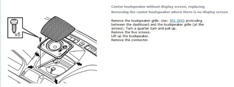

Does anyone know how to remove the mesh surrounding the inbuilt Sat Nav screen in a 2007 XC90
Old Nov 28, 2021 | 05:53 PM

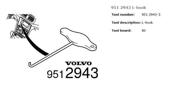

Use a hook to carefully pull the grill up - it bends easily - volvo's special tool is pictured. Instructions are the same for cars with nav just the speaker is smaller and there's a slot for the nav screen
