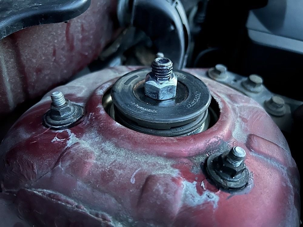

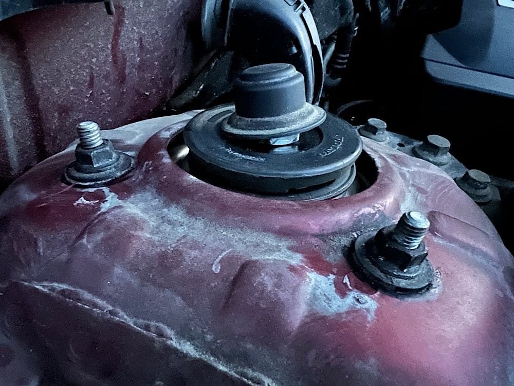

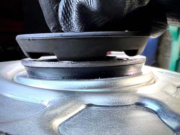

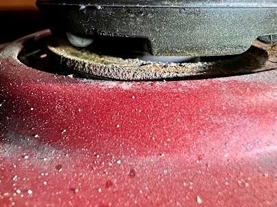

So I replaced the right front strut and upper mount/ bearing this weekend. (Would’ve done both but FCP Euro screwed up the order and only delivered one strut. -Unusual, because they’ve been great so far.) The bearing had a very slight amount of play which I think was contributing to some minor noise over bumps, so I opted to replace it.
One thing I discovered upon re-assembly; the “+” nut which holds the top mount wouldn’t go down far enough, so the top nut and spacer wouldn’t tighten all the way once the bearing was in place. Both nuts were completely bottomed-out and still left about 1/8” gap, so I ground 1/8” off the metal spacer of the new top mount. It was visibly taller than the one I removed, which appeared to be OEM.
The attached photo is before I ground 1/8” off the spacer.
Didn’t take an ‘after’ shot, was in a rush to wrap things up and forgot.

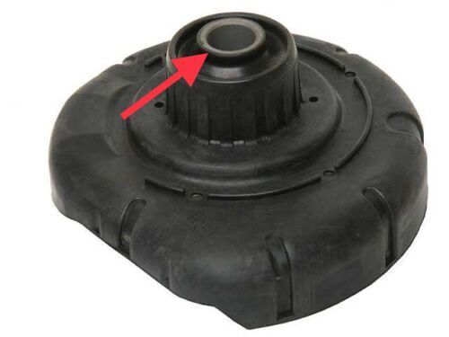

Using a stock photo from the web; this is the area I ground down 1/8”…
Without doing so, the bearing wobbled ever so slightly because the top nut and spacer would not completely close the gap. Anyone else experience this?

Didn't compare to the other side, as I wasn't going to replace it at that time (strut didn't arrive on time,) so it didn't make sense to unbolt everything on that side just for the sake of comparison. I was meticulous about putting it back together the way it came apart... Spring was seated correctly on the bottom seat/rubber isolator, top mount was seated correctly on the spring, "+" nut was on correctly (I even reversed it to see if it made any difference; It didn't,) then the bearing went onto the top mount, then the spacer, then the top nut. Not much to screw up.
I did my due diligence beforehand (looked at parts diagrams, watched a number of videos from 1A Auto, FCP Euro and others,) and I'm certain everything went back on properly. I think it was simply a matter of either the metal spacer in the middle of the top mount being too tall, or the bearing being too short. If I had used OEM Volvo replacement parts it might not have been an issue, but they were way too expensive.

Following up on this; The other strut finally came in and I replaced the left front weekend before last. Same thing on the left side… Space left between the top bearing and washer/spacer/ whatever you call it was the same. No clatter that I can hear from either side, so nothing is loose. I guess that’s just the way they sit. Don’t know what else to make of it.
