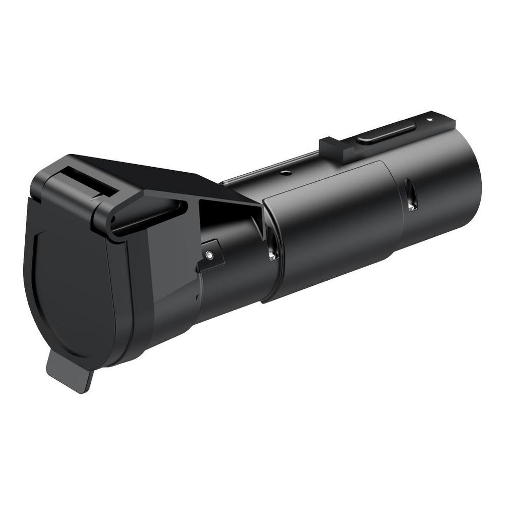

Volvo XC90 OEM electric release hidden stealth hitch that swings out from underneath. There is NO Brake Controller option that can be installed on this vehicle. You will need to get a wireless Bluetooth Brake Controller that hooks up between the trailer wiring and the tow vehicle's 7-way plug/socket. Very Easy DIY. No perm install.. Easy install, easy remove.. Amazon $244
CURT 51180 Echo Mobile Electric Trailer Brake Controller with Bluetooth-Enabled Smartphone Connection, Proportional, Black PLastic, 9 x 9 x 3 inches, BLACK PLASTIC
