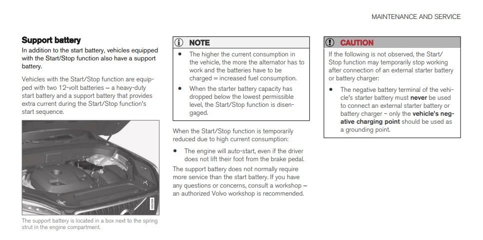

I have a notice on the dash of my 2018 XC90 about the start / stop needing service and from what I can tell, that means something called a support battery needs attention.
Can one of you kind folks tell me what exactly this support battery powers, and when? And also, where is it located?

Page 601 of your owners manual
