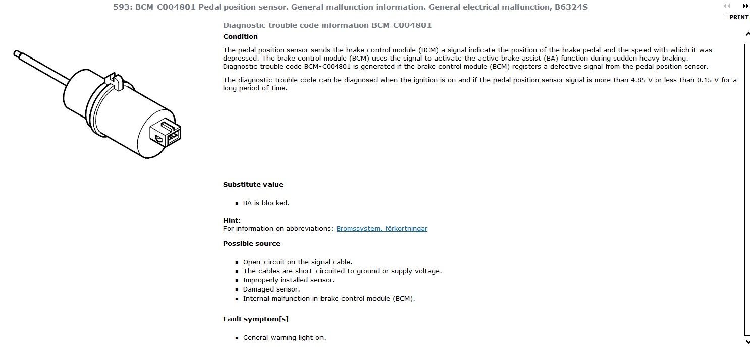

Hello, I own a Volvo XC90 2010 model engine code B6324s
The vehicle records error code P061B64
And I don't know how to fix this error
I have another error P222700
Where do I find the missing line
Old Nov 18, 2020 | 12:57 PM
This info for the brake code? And click the other codes to get diagnostic trouble code info for them also.
