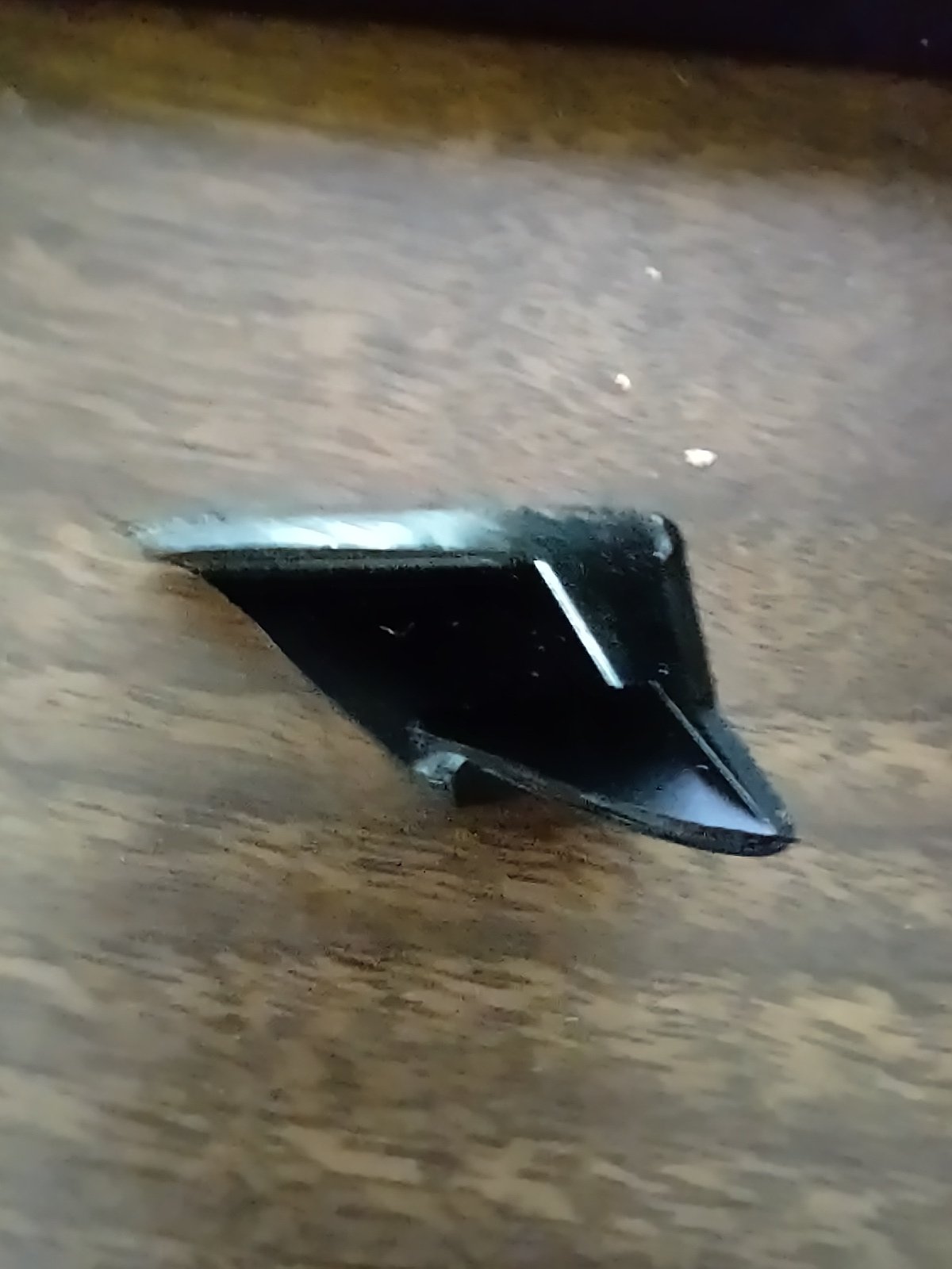

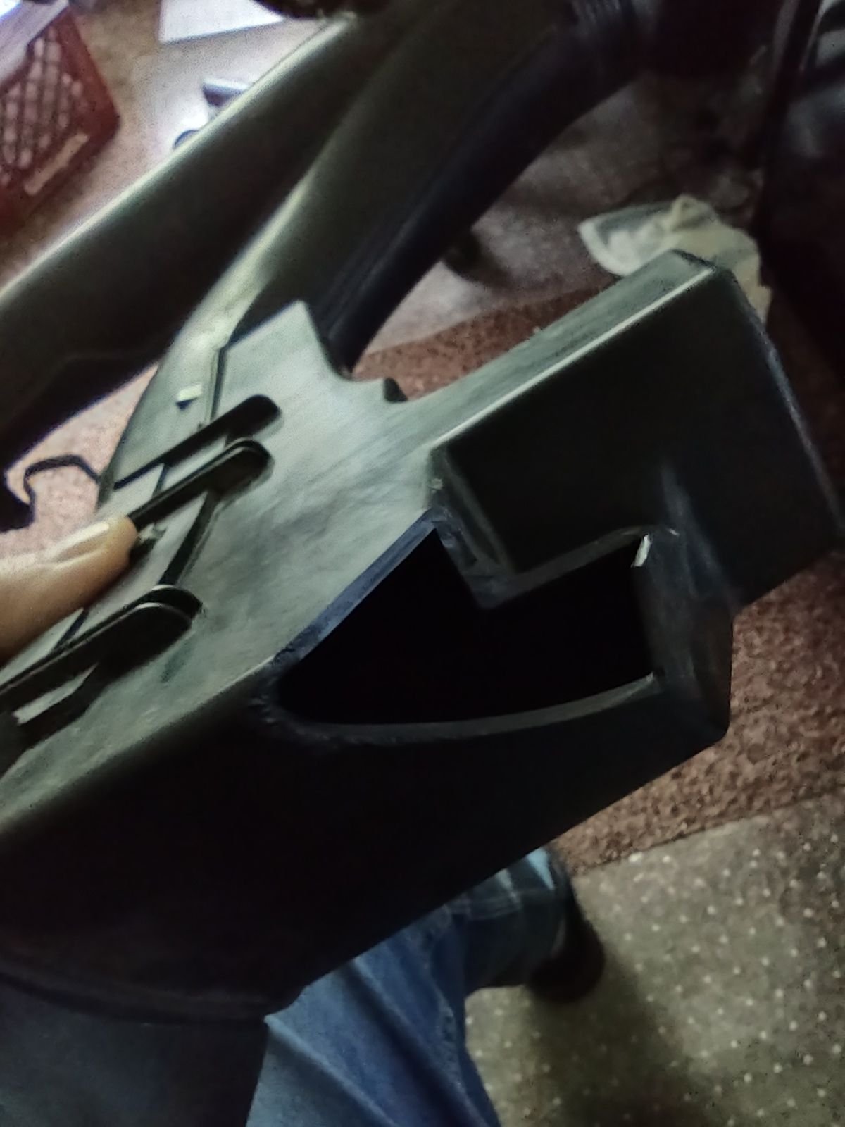

I had the same symptoms after replacing spark plugs (yes, Volvo plugs!) and a new Bosch MAF Sensor on my 2004 Volvo XC90 T6 AWD. I somehow didn't notice the broken piece off of the Inlet Pipe near the Top Motor Mount till my girlfriend found the piece the other day. Took the Inlet Pipe off and Voila! Piece broken off. I'm going to try J-B Plastic Weld on it and some electrical tape for good measure. Here are photos of the break:

For those having this same issue and pulling their hair out, add another victim of the plastic turbo inlet pipe being broken by the driver side engine mount. Mine looked almost identical to toddster1's and was the source of all my trouble. Replaced it and have been trouble free for years now.
