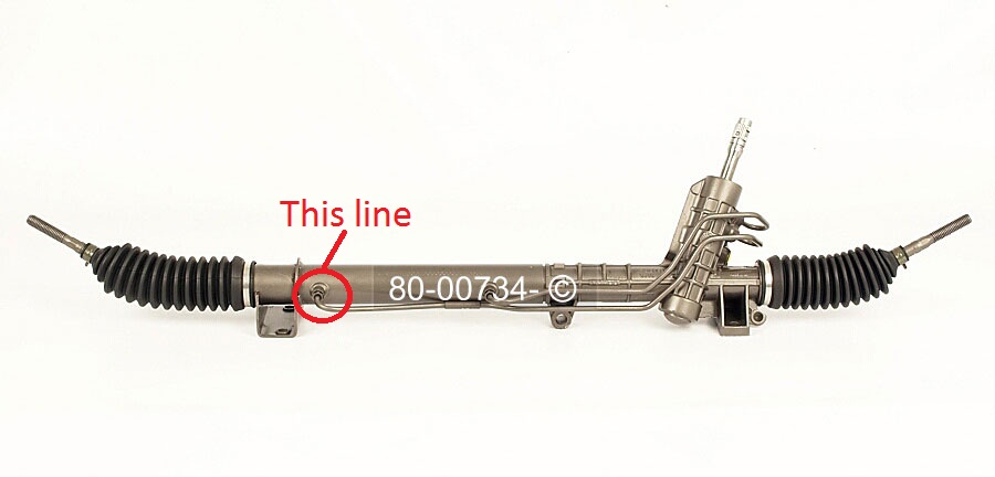

Hey all, New to the fourms. is there a way i can change just the line on the rack and pinion. everything else is good on it

if all else fails get the right size brake line and a tubing bender

Yea that is my plan. But i just want to know if its possible to do the flare for it. its like a double flare with an O-ring

Where i am the only way i can get the line i need is to have the rack sent out and be rebuilt or buy a new one. i really dont want to do that because everything is like new. So i will try the double flange with an O-ring and hope that works. i only gave $600 for the car but i really dont have the money to drop on a rack and pinion.

I wish i could use that. my line snapped in half at elbow

If all else fails you might need to find some old guy who really knows how to weld and likes a challenge and he might be able to braze the parts back together. Brazing doesn't take as much heat so might be possible depending on how much distance and what type of a heat dam could be used to protect the hose to metal crimp. You could call around. Worst case is you don't find anyone but if you do and it works you'd have a quality repair and a proper sealing arrangement between the rack and hose.
I know this isn't going to help you with the broken elbow on your line but the rack is available in the aftermarket should someone need one. Maybe Spike was talking about from the dealer but A1 Cardone presently has rebuilt racks on hand and available to parts stores. Oriellys has it for $274.

Go to a wrecker like Pick N Pull and get another line. Simple.
Do you have wreckers that let you pull parts? We have a mixture of some 'Elite' wreckers that wont let you set foot in the yard and others that say go get it yourself.
