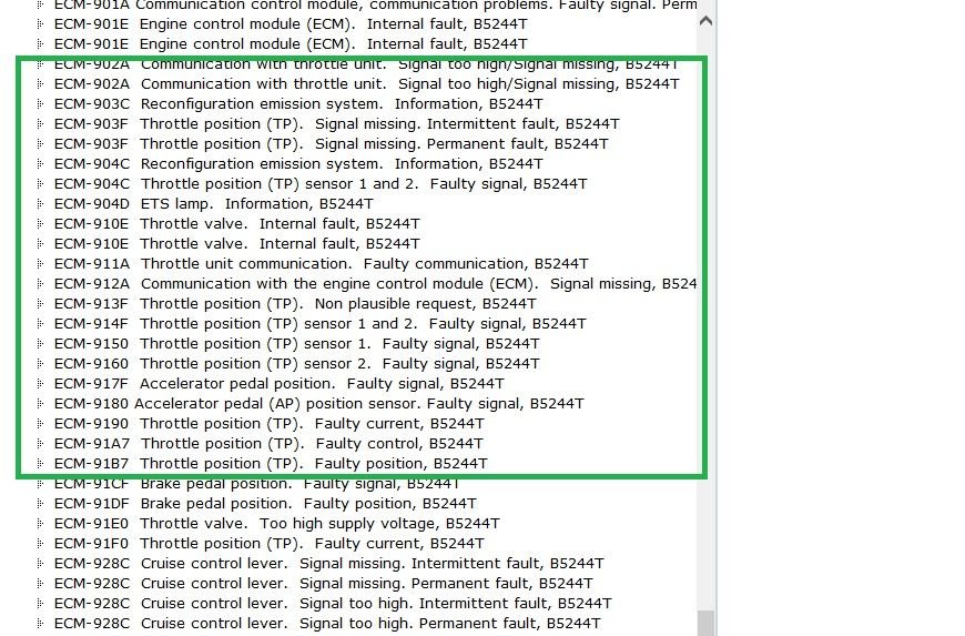

A bad throttle module maybe - usually there will be codes related to that stored. Possible codes below. Does your scan tool talk to all the control modules? Sometimes the throttles seize or become very stiff, should be able to push the throttle plate open with your fingers (I know it's not easy to get to and it's spring loaded so it takes just a little force) A used part may or may not work. Technically the throttle is "coded" to the VIN of the car. Some have had success with a used throttle module. (applies to 1999-2001, some 2002 year models only) Note there are no Volvo codes that say "idle air control valve" - so not sure what kind of scan tool you are using.
