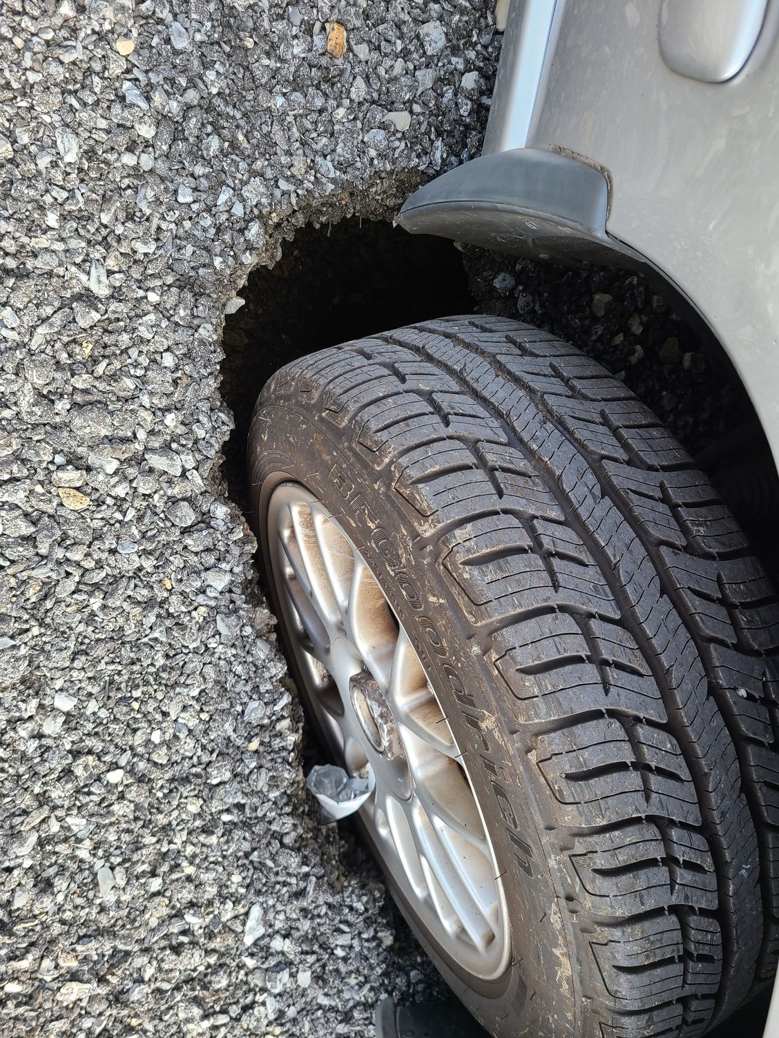

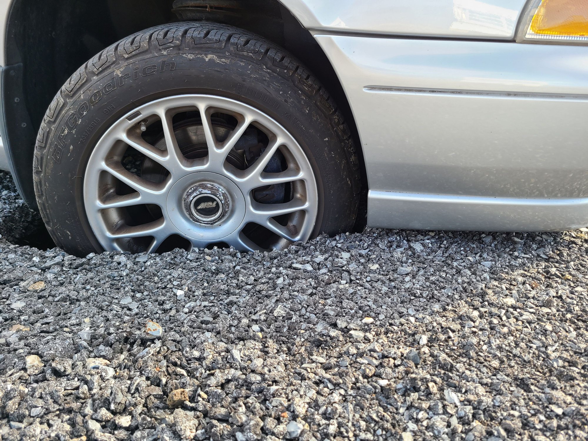

So I parked my car, and a sinkhole opened under the front passenger tire 30 seconds later. It was on private property so they called a towing company who had to send 2 trucks to get it out best they could. Nose damage was unavoidable I had it flatbedded to my mechanic to make sure there are no mechanical/suspension issues. It was resting on the frame horn so I hope that's fine. SO- where would be the best place to attempt to find a bumper that would replace the scratched one? All suggestions welcome!! There was nothing wrong with my baby aside from a broken air dam before
To get the car out they had to wedge a flatbed under the nose/front bumper, which scraped the whole thing. I asked about an airbag to lift it, but the macadam integrity was questionable so that wouldn't work.
