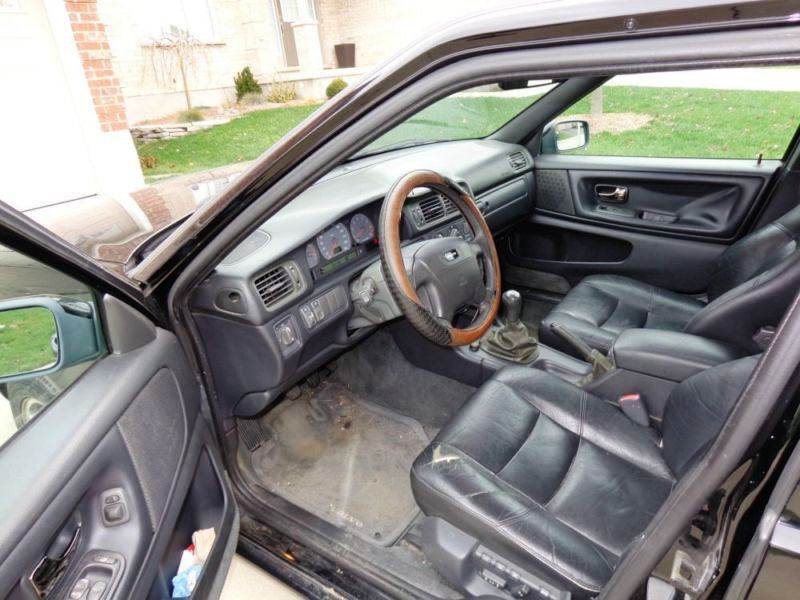

I did mine this week. Bought the fronts/door panels/steering wheel/and some wood trim. Its easy. Disconnect battery, there's 4 bolts per seat, unplug harnesses, lift up side trim panel on seat, unbolt seat belt, remove seat. Reverse to install.
Attached Thumbnails Interior Swap-%24_20-4-.jpg   Interior Swap-img_00000073.jpg
