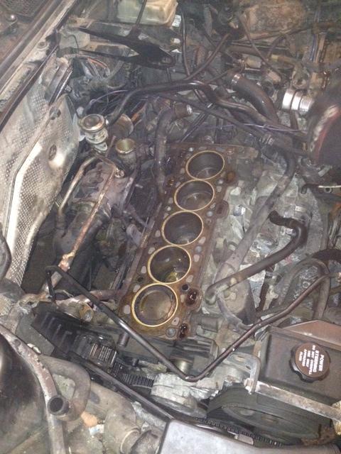

Long story short. I get the head off. (broke a head bolt in the process, FUDGE) The cylinder #2 misfire code I have been getting checks out, burnt intake valve. Going to resurface the head, install all new valve seals and check out that valve on #2 to see if it need replaced. I also plan to rebuild the turbo, (and throw in some goodies from IPD while I am at it

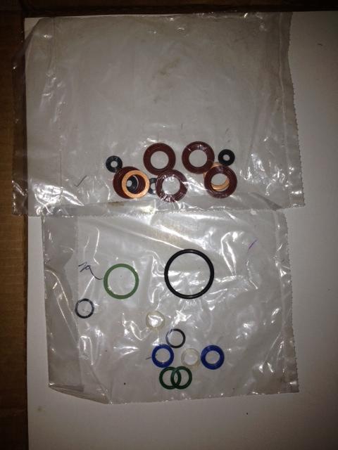

• Can anyone tell me what these are for (from the full felpo head gasket set)

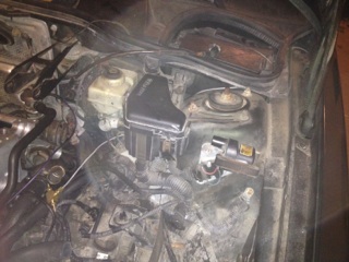

Everyone who says, taking the turbos off on these engine is smoking crack. either they state this for the non AWD versions, or they know some tricks I don't. AND, some of the engineering that went into this engine layout......what the! Bolts in bizarre places and hard to reach angels have never made any mechanic happy. Volvo engineers must hate mechanics. Least now I know why (well, even more so) they cost so much to have worked on!

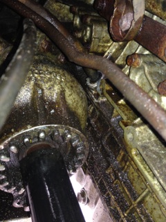

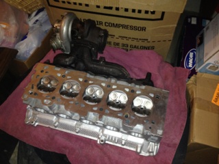

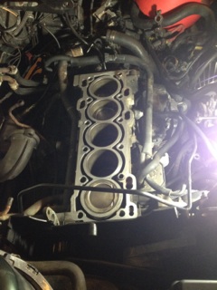

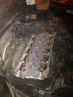

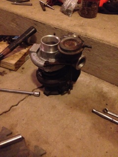

Photo of my work as it stand for your viewing pleasure, well, the turbo is off now too.

• Can anyone tell me what these are for (from the full felpo head gasket set) ( I am not sure exactly what you are asking.. Is it what is in the bag?

THANKS mau5pad for the reply! Yes, the parts in the bag, I didn't use them/didn't need them. Found that the one set of brownish seals were bottom injector intake manifold seals, I did use those eventhough my car did not originally have them installed. PaddyG, I dunno, I am only on this volvo site but recently found the VolvoXC forum so I might sign up on there. TO ME, volvo owners are either to rich to work on their own stuff, to yuppie or hipster to know how to wrench or just lack general knowledge to work on the volvo they own, but thats just my general conclusion. I mean, I'm a guy who is right at home in a black tie event or a redneck mud bog, so I meet and affiliate with all types.

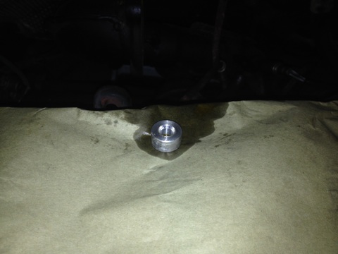

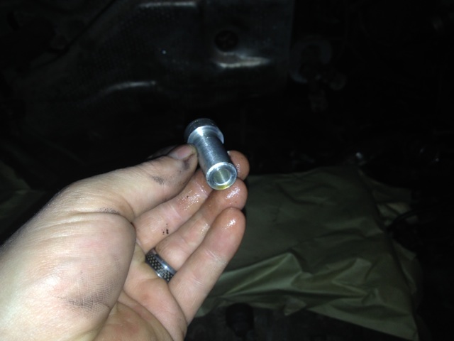

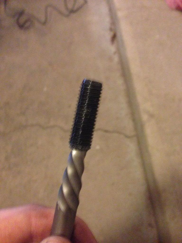

My engineer brother made an extractor sleeve for me, worked perfect! Soaked the bolt for a few days with PD blaster, put in the center drill sleeve, drilled it, put in the extractor and it came out, YESSSSSS!

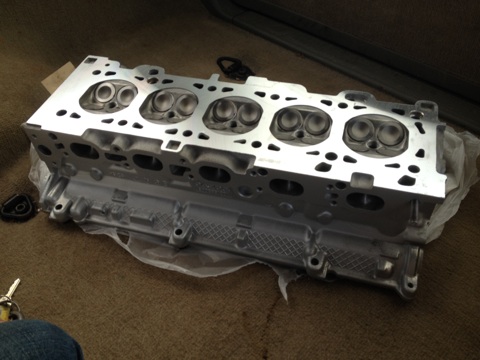

In the midsts of my rebuild, I went on my honeymoon to the Riviera Maya, dropped my head off at the machinists and took off to da beach. Picture from my resort for you all to enjoy!

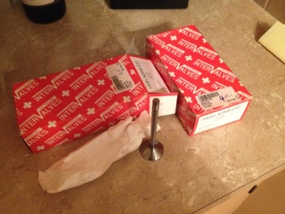

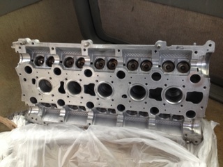

Got back and went to pick the head up, guy tells me its cracked.......WTF. I took it for another evaluation, come to find that the intake valves are all bent slightly, doh, must have been from previous owner slipping the belt at least once. SO, new valves and new valve seals in. Needless to say, first guy will not get ANY other business from me ever again. Other guys however will get all my business, they do amazing work!

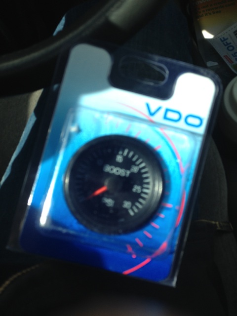

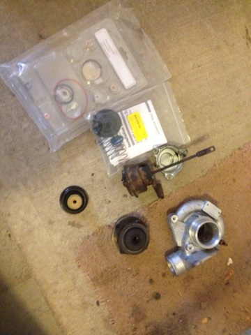

Rebuild the turbo from ebay kit, parts were not perfect, should have known better..... anyways, use some old parts, some new parts and make it work. Installed a gauge and IPD gauge pod (also installed the HD blow off valve kit (10-14psi spring) and the HD TCV module. Fun go faster parts! On a side note, the Gauge that IPD sells is a vacuum PSI turbo guage, and that is how they have directions to hook it up. I bought a regualr turbo gauge that works on pressure. I tapped into the turbo housing line that is fed into the TCV to get my reading. Its cool to watch the needle move when the turbo kicks in, and boys does it. The upgraded TCV works wonders on the S (sport) setting! Combined with the HD blow off spring, I get to about 14 PSI now before it dumps off. Stock is 8. I can feel the difference. Havent laid into it to hard yet because of the fresh rebuild and all.

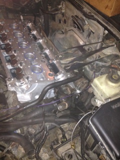

Got it all back together the other night, do a final oil flush and shes now purring like a kitten. One small issue was an oil leak from turbo oil drain tube, the fel pro kit does not supply a new one. I RTV'd it! day after the rebuild and perfectness, the crank position sensor goes bad........ugh.
