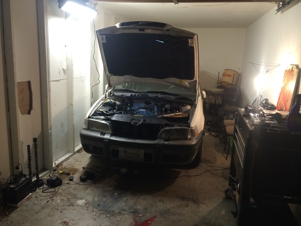

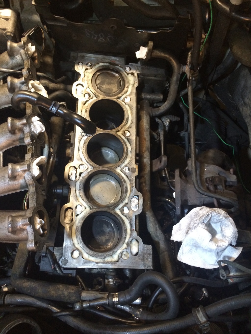

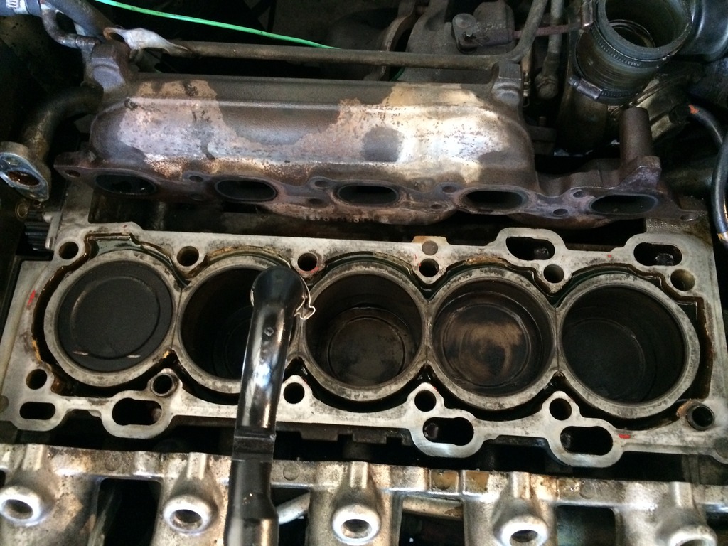

After just 3 days, I managed to blow the head gasket (no coolant, milky oil, white smoke, etc) which I will learn is because of subpar machine work and a tech that allowed a head to be installed that should have been replaced.
So, I pulled it into my garage and got it apart pretty quickly (except for one stubborn as hell exhaust/turbo manifold bolt

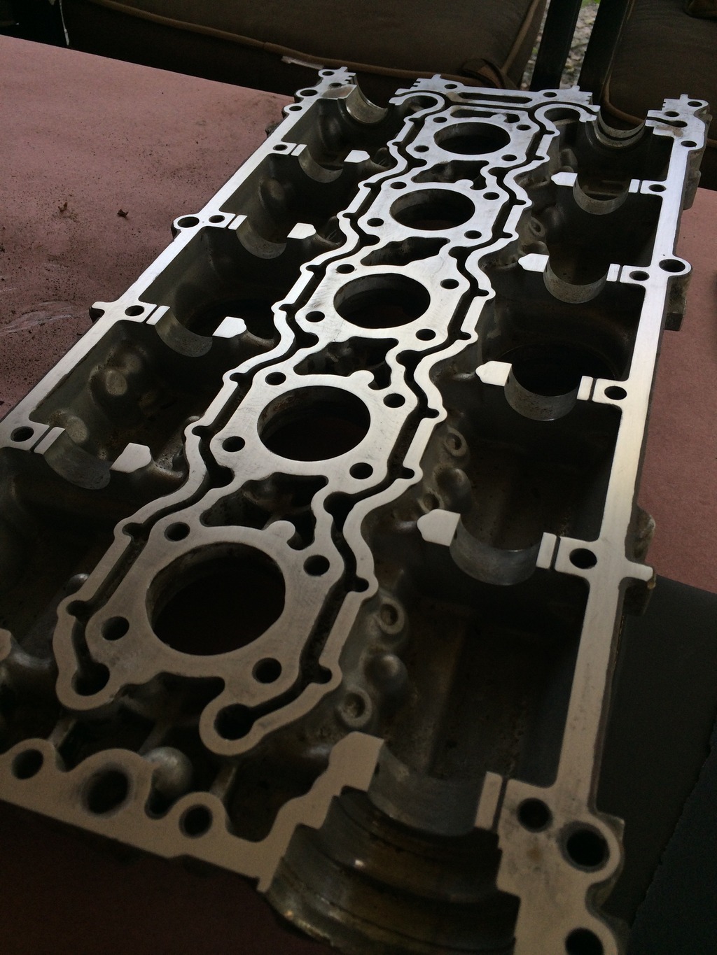

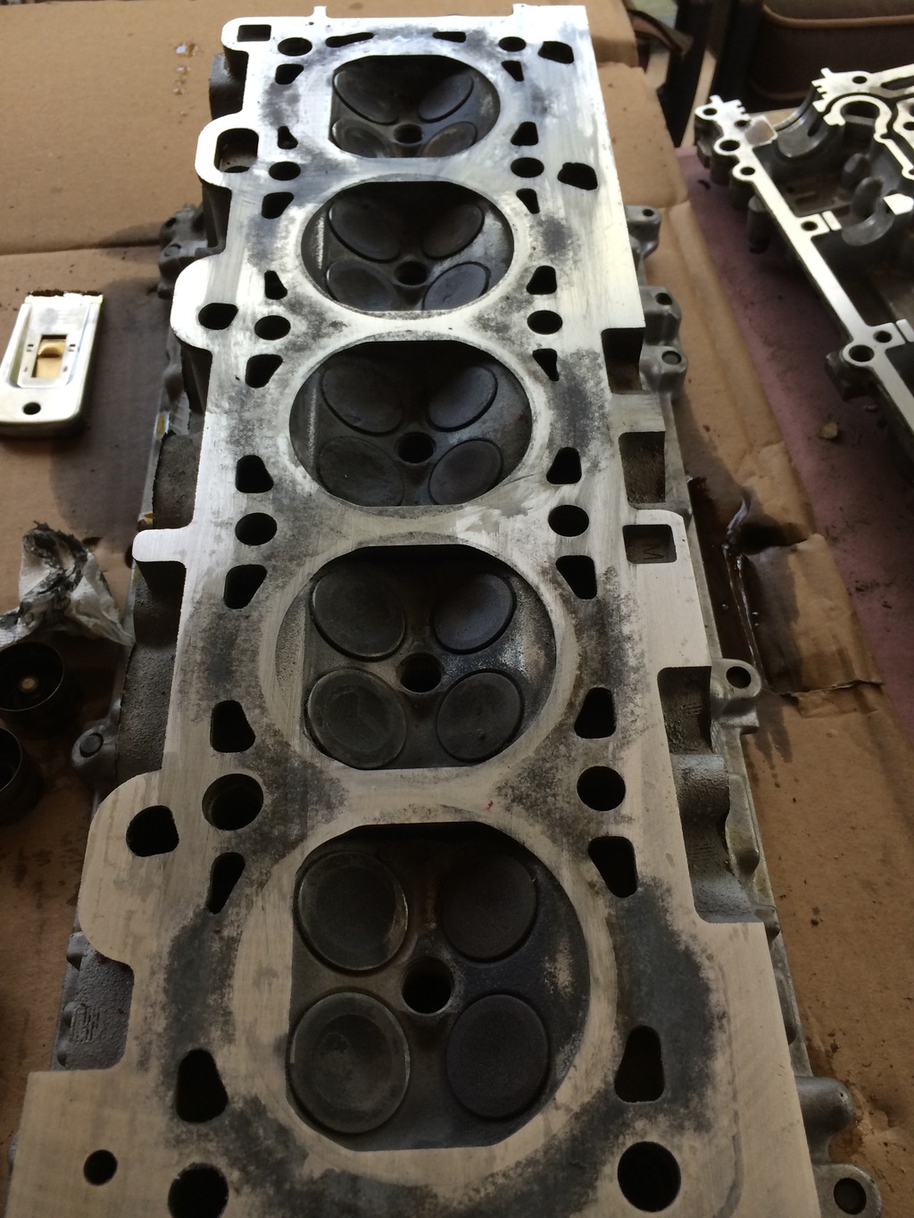

Then I began to degrease, wash, and resurface the valve cover, head, and block
Note the uneven and completely ground deck on this head which also caused some good valve marks on the pistons (all of them)

Also started on the block by removing the alignment dowels and making some space for resurfacing
Now just waiting on my parts and the used head I found and bought today on the web.

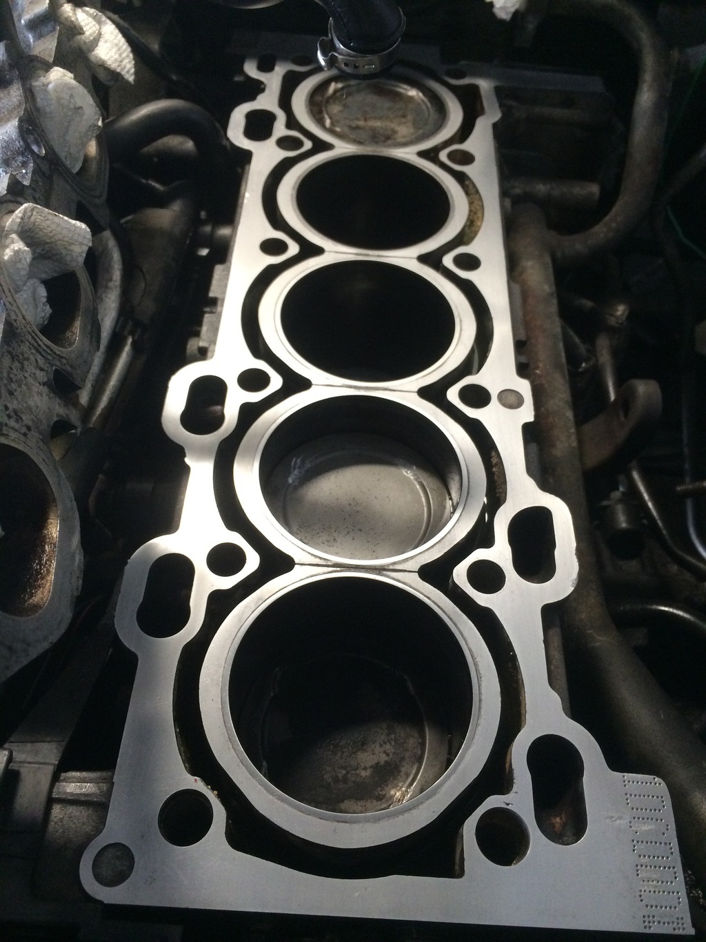

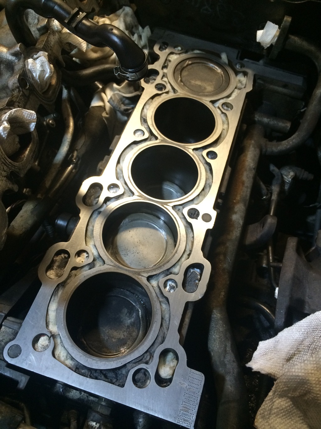

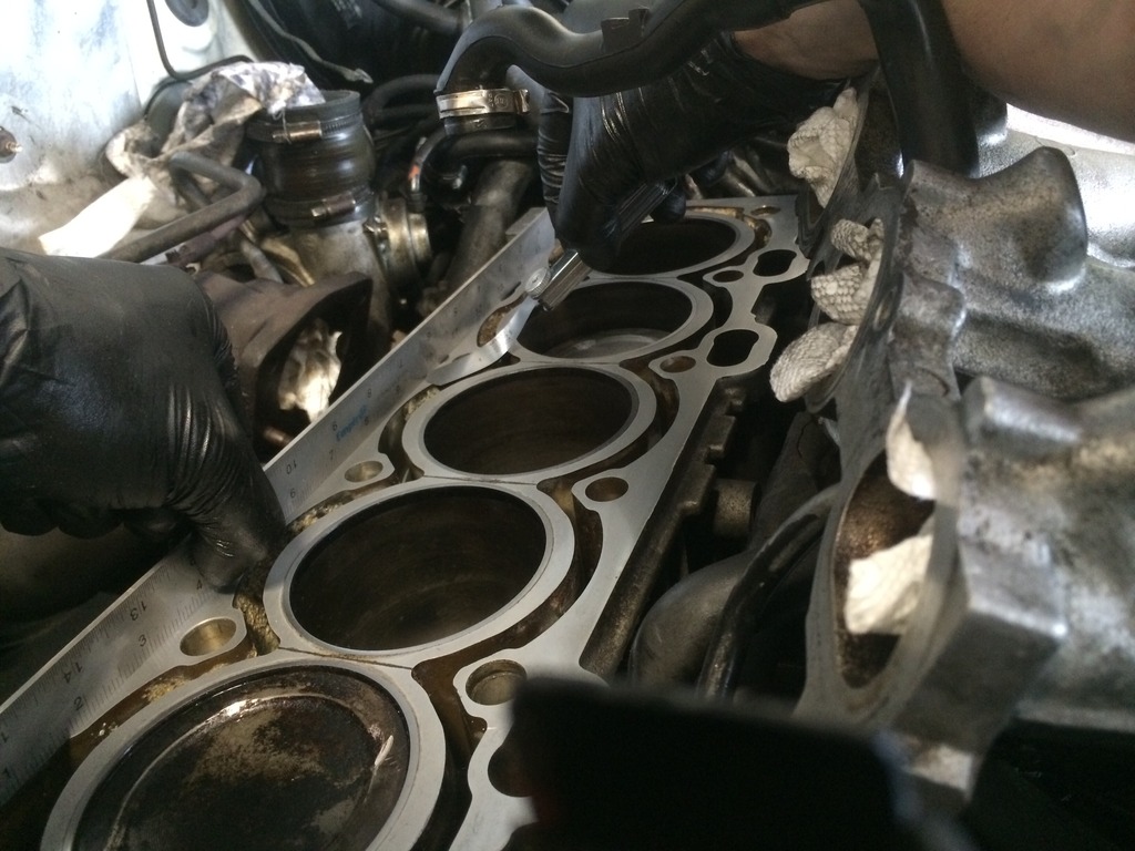

Update on the block surface
220, 400, 800 about 2.5 hrs total on prepping the block
Block seems to be within .0015" for level with straight edge and gapping shims
The before pic
