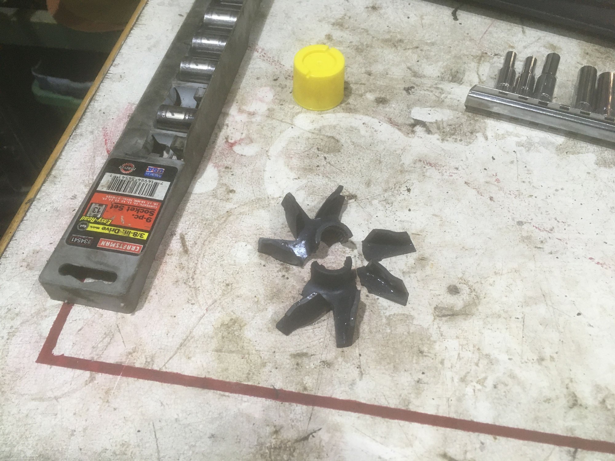

Default Fixed
As Adam Savage would say : "There's your problem right there!"
Yep, water pump.
Thanks everyone I appreciate the support.

Old Apr 1, 2021 | 07:46 AM
patsusedparts's Avatar
Joined: Feb 2012
Posts: 12
Default Solved - failed WP impeller
So I wanted to wrap this up. I fixed the car, so all is well on that front. A few people have inquired about the old pump. I am attaching a photo of the only marking on it. I actually did not purchase or install that pump in 2012. The car's previous owner (friend of mine) brought it to a shop for service. They said it had jumped time and the belt etc needed to be replaced. The owner approved the work. The next day the shop called and said we replaced the timing belt but now it won't start at all, so you must have bent valves from the jumped timing. At that point the guy said NO to the $3300 the shop wanted to fix it, and he sold it to me. Short story, the shop had the timing well off. So I pulled the head, (nothing was bent) and had the valve job done and put it all back. And I drove it for 9 years with the parts that shop had installed.
So back to the pump, the only brand I see is "Altrom". Which I am not familiar with (obviously, I'll remember it NOW!!)
