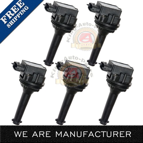

You need to start by throwing all of your original coil packs in the trash and replacing them with a new inexpensive set readily available. Here's some that we recently purchased:
https://i.ebayimg.com/images/g/UZUAA...2mi/s-l500.jpg
Then, with the plugs in and the old coils out, spray down the top of the enging and wash out all of that oil. Use a biodegradable degreasing agent.
Then, use compressed air to blow the water out of the plug wells and off the top of the head. Blow the connections to the coils dry.
Then, with everything dry, install new coil packs.
Replace the oil seal at the oil cap - that's where your oil is coming from.
Unhook and reconnect battery, try again.
