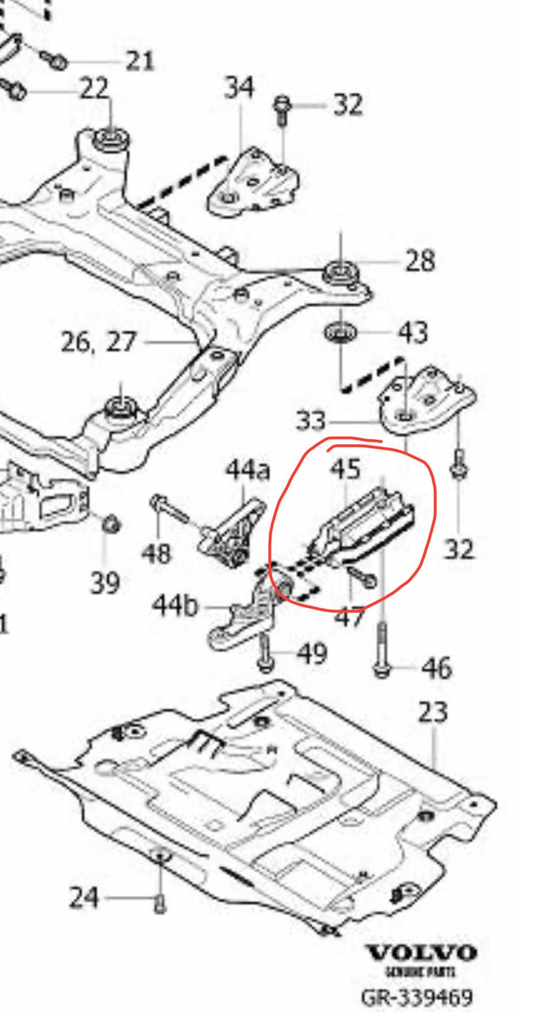

Where is the part circled found?

Here's a picture of the diagram with your part correctly labeled.
Number 46
Torque Rod
Number 46
Torque Rod

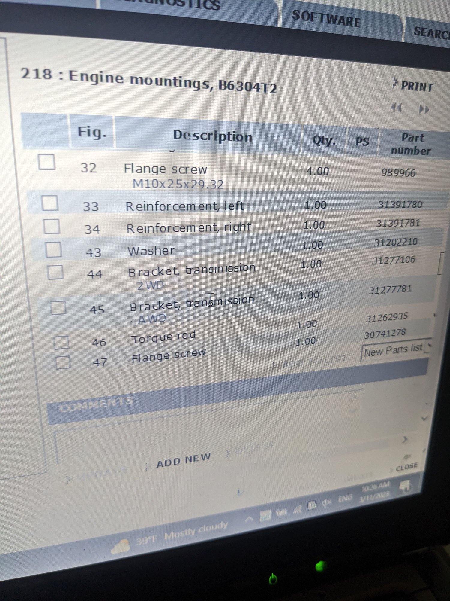

Do I find it by going under and removing the splash shield or from under the hood? Mine is 2-wheel drive so I’ll be looking for bracket #44.

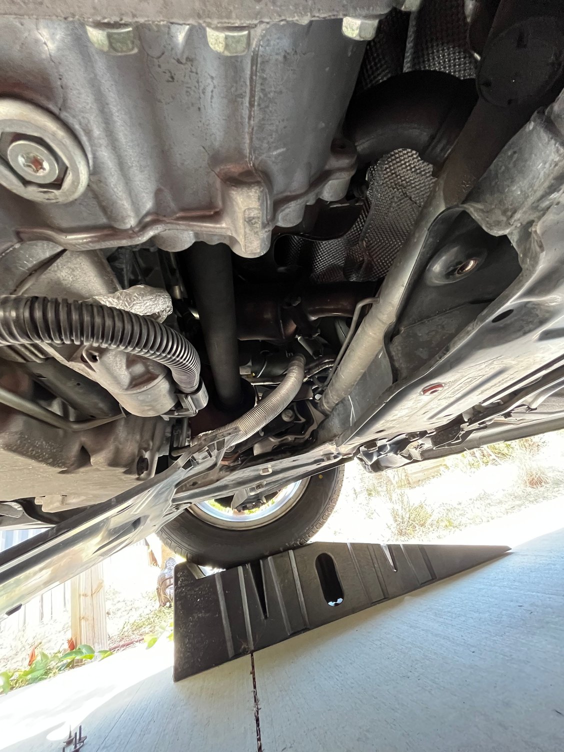

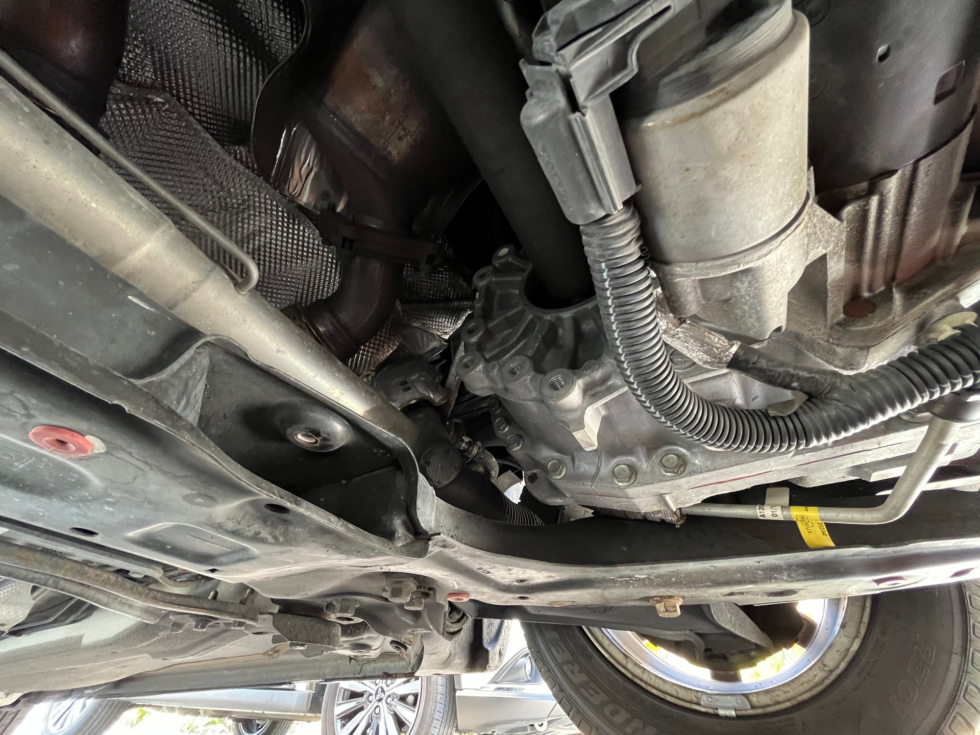

I’m guessing either this support was removed or not there on this model.
View toward passenger side.
View toward driver side.

I can't see the area where it would be on these photos. Watch this.

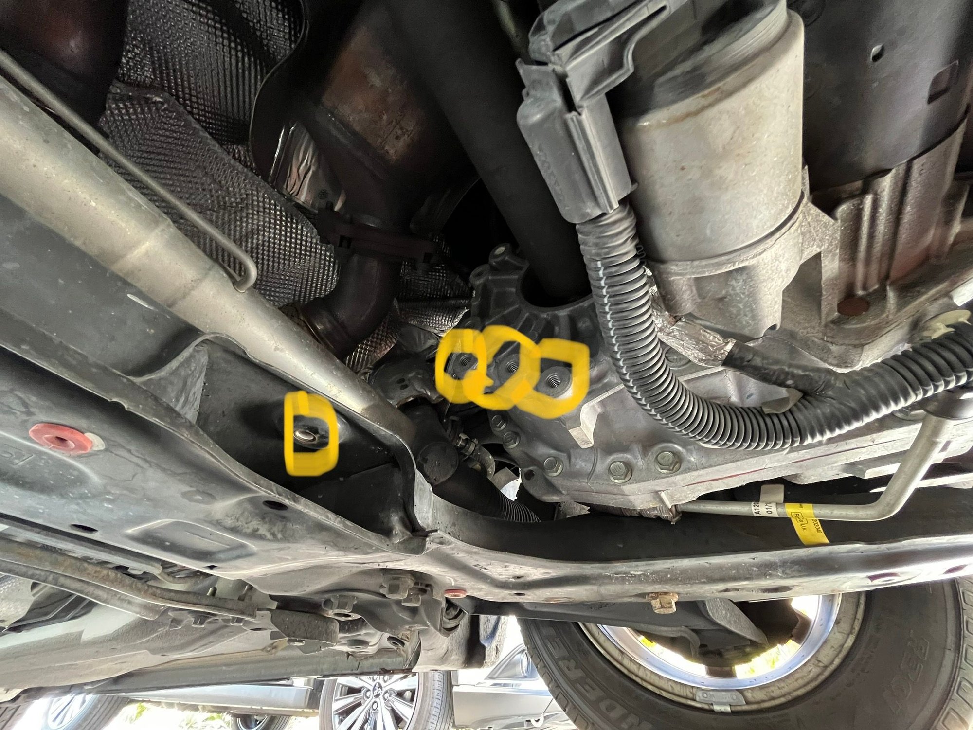

This is the area I expected to find the torque rod. These empty bolt holes suggest it’s missing? That video was for a more forward mount, not the mount pictured in the parts diagram.
