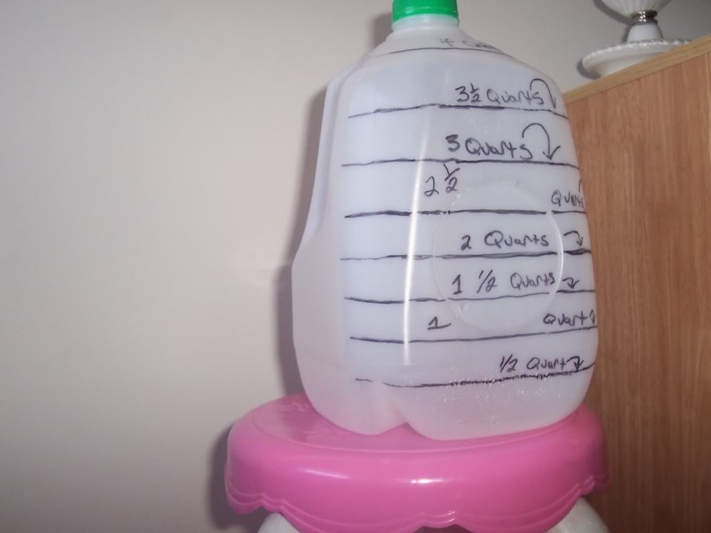

That and the trouble of draining out 1 quart. If you're pulling the plug to drain out a quart and the fluid looks bad why not just dump it all out for the same amount of effort ??
One trick is to save an old 4 or 5 quart oil bottle and pour what came out into the bottle to measure it. Most have a little see through strip and some graduations for OZs on the end. That way you're back to where you started since our transmissions are notorious for being difficult to read.

I didn't mess with the drain plug. I pulled the trans cooler line, pushed my hose on it and placed the end into an empty 5qt oil jug and started it up and slowly rowed through the gears until I saw a few bubbles coming through the line and shut it off. The bubbles shows the trans is near empty as it's starting to suck a little air. Dropped in three quarts and did it again, and again. Mine took almost 12 quarts until it turned red. It was a very dismal black colored crap that came out.
If you use the drain container to measure what's coming out you know you are putting in the exact same amount. If you're sure you are good when you start then you should be at almost the same spot when you finish flushing. And yes, I didnt' use a new clip or new O-rings, my bad.
