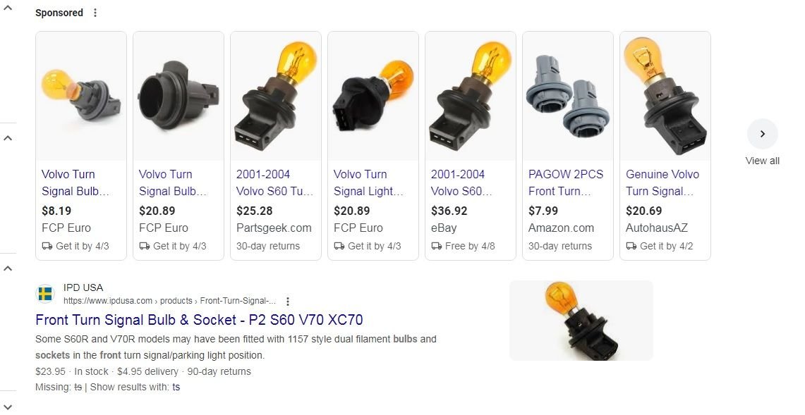

Yes - you have a bad socket. Have replaced many. The Volvo part comes with a new bulb also. (there are 2 different sockets. 2 or 3 terminal - make sure you get the correct one for your market.)

That's great - Thank you! I will check the terminals and get one on order.
All the best, Paul
