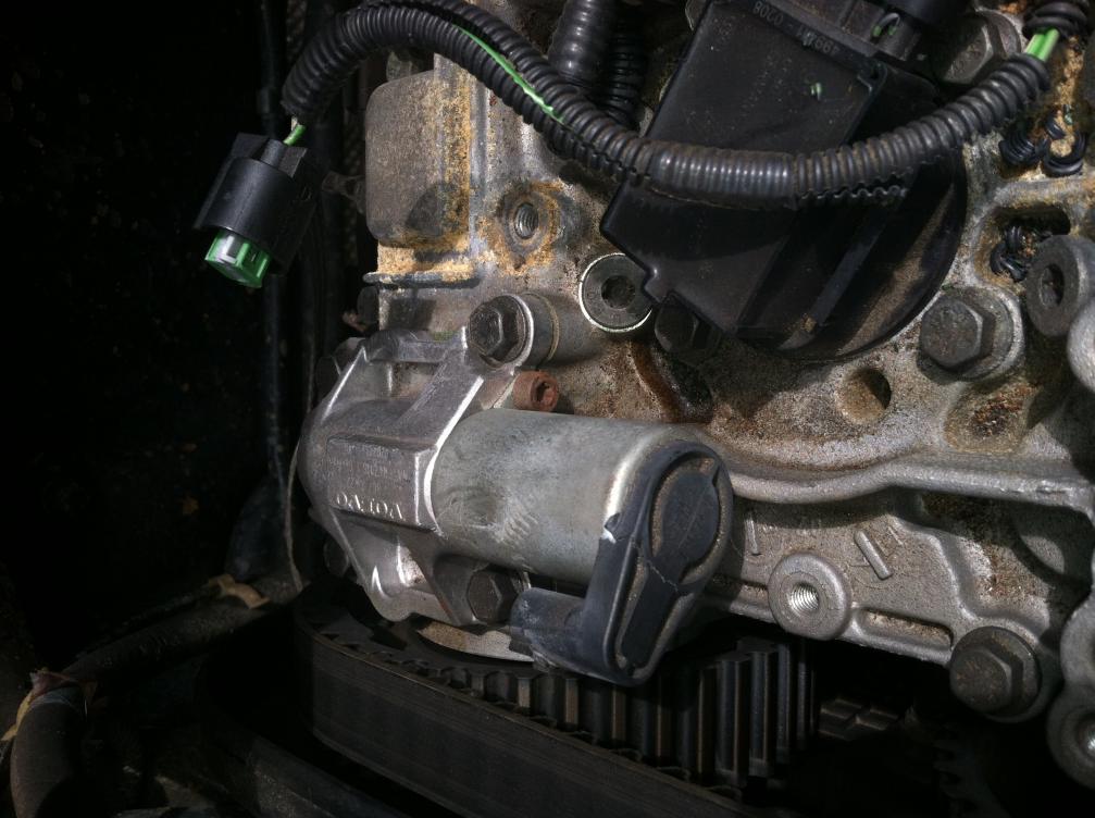

also... i have tried to buy a new camshaft positioning sensor but everything i find at my local parts house doesnt resemble what im looking at on top of the valve cover right behind the cam gears.
is what im looking at correct in being the CPS?
also im just looking for any idea anyone might have seeing as how i must get this running right soon so i can return to work in central florida. i realize im not a member here that contributes but could really use the help from some guys family with the 2.4l from volvo
bel;ow is a picture of said sensor im looking at

That's not the cam position sensor. It's the oil control valve for the VVT. Leave it alone.
I'm no expert on your car but I vote you have one or more bad coil packs. Buy one new one and start swapping it around.
Besides that, what plugs do you have installed? If you have any kind of silly plugs - Bosch +4s, etc., get rid of them and install basic copper plugs - Volvo OEM or equals.
