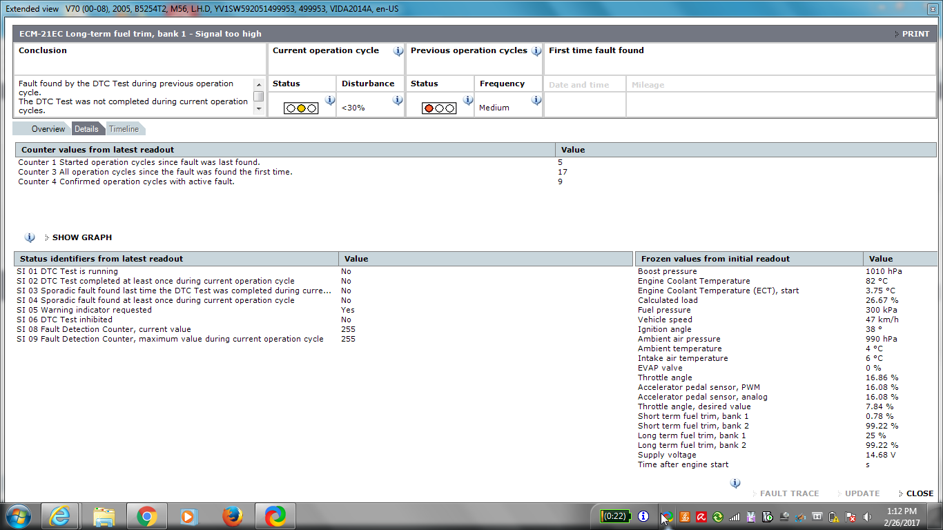

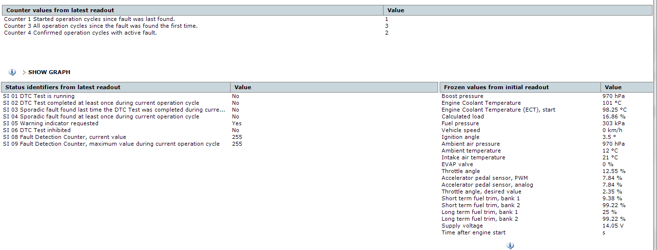

My 05 v70 2.5t has been giving me intermittent problems for some time now.
This weekend it was much worse. I did about 1 hour of stop and go traffic in the city. As soon as I did my errands and restarted the car the problem recurred.
It seems to run fine after if it can cruise at about 60km hr. The problem seems to iron itself out so to speak. It's mostly idling/traffic driving that triggers continues the problem.
On hot start the car would stumble, idle like crap, miss fire (blinking CEL ), and stall.
I have done the following tests/repairs;
FPS (on rail) sensor replacement
Upstream O2 sensor
Fuel Filter
OEM Plugs less than 1 year.
Air filter
DIY Smoke test (smoke only came out of airbox)
I have attached some VIDA read outs, hopefully someone seems something out of spec because I'm kinda stumped.
Thanks in advance;
Attached Thumbnails Opinions needed: 05 v70 2.5T miss fires after hot start-iexplore_2017-02-26_13-11-13.png   Opinions needed: 05 v70 2.5T miss fires after hot start-iexplore_2017-02-26_13-12-10.png   Opinions needed: 05 v70 2.5T miss fires after hot start-iexplore_2017-02-26_13-12-32.png   Opinions needed: 05 v70 2.5T miss fires after hot start-iexplore_2017-02-26_13-13-00.png   Opinions needed: 05 v70 2.5T miss fires after hot start-iexplore_2017-02-26_13-13-19.png

intake air temp sensor? anything odd about the temp gauge to suggest the ECT sensor?
Old Feb 27, 2017 | 02:56 PM
rebeleye's Avatar
Joined: Aug 2012
The coolant temp on the dash seems accurate as do the hot start temperatures. I supposed I could swap in a new ECT as they are cheap/easy to install. I may have to see what the ECT reading is the next time it happens.
