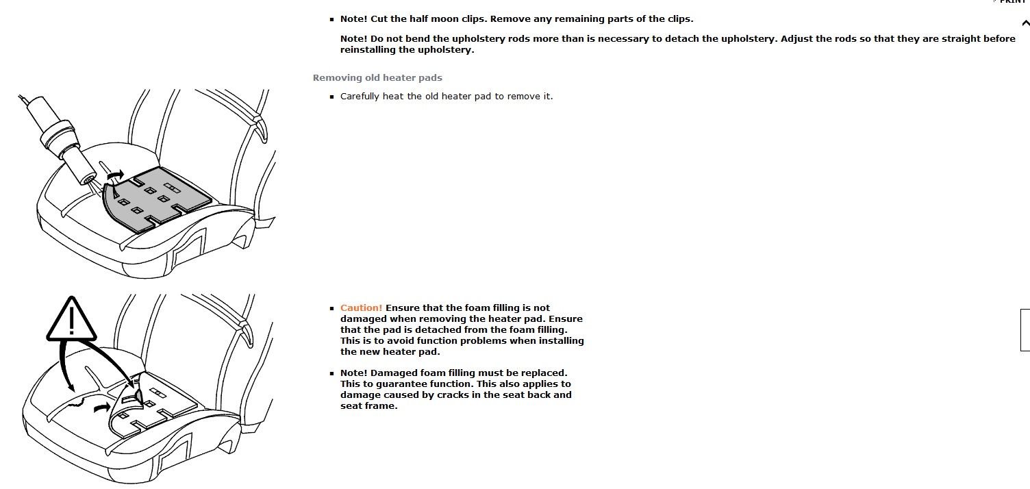

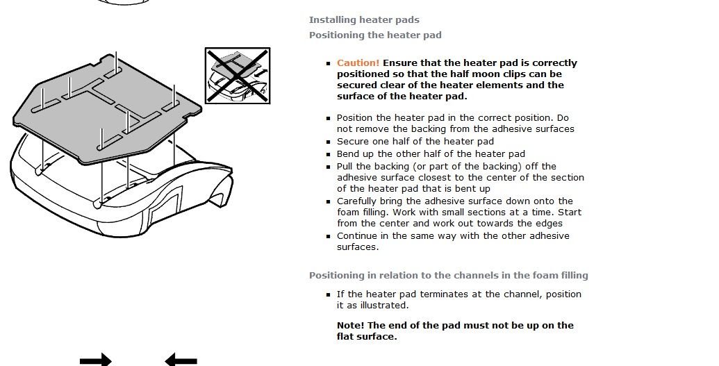

Hi all,
The drivers side seat in my 2001 v70 went bad. I see where to buy them and there are videos how how to take the seat apart but how do you un-glue and glue the new element in place. No information on that.
Any help would be appreciated.
Thanks,
Matt
Old Dec 30, 2020 | 01:32 PM
Here's what VIDA says
