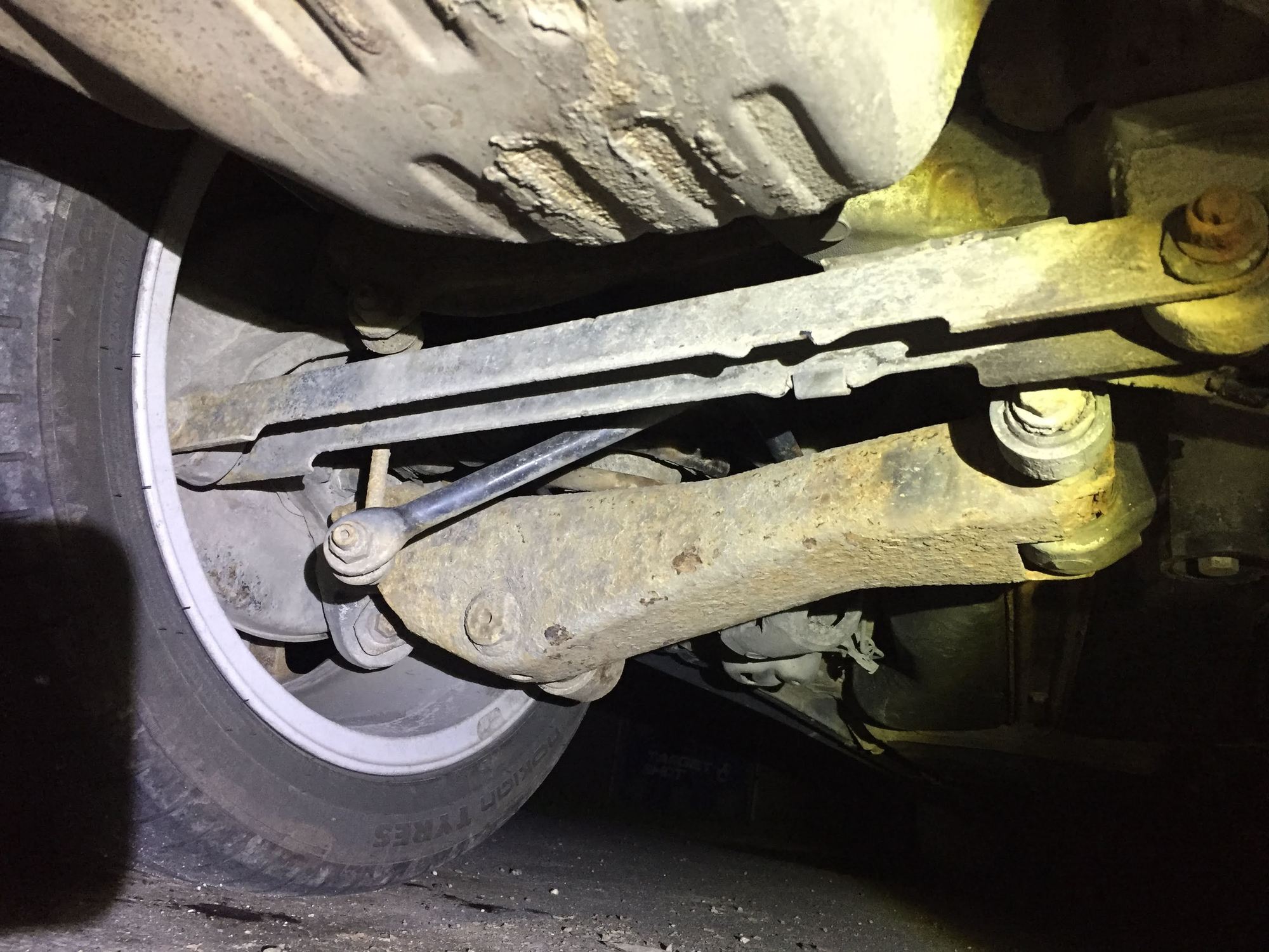

Rear end left
Rear end right

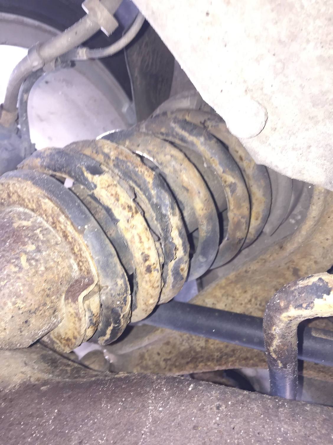

I had a look at the rear springs (see pics). The springs were under load (wheels on the ground) when the pictures were taken.
Could these worn springs cause the too negative camber in the rear end? And would this affect/cause the steering pull?
Rear right spring.
Rear left spring
To my understanding, the car has Nivomat shock absorbers in the rear end. At least according to the suspension/spring code (65) on the identification plate (see https://www.ipdusa.com/techtips/1001...oes-it-tell-me).
Old Sep 6, 2020 | 04:02 PM
No, it's your front camber and the crown of the road, and looking the the rust i'm glad I live the in south. The sagging rears might be cured with new nivomats but are very expensive!
According to Volvo’s wheel alignment the front camber it is within specifications. I could try the special camber bolts you suggested. But when I tried to correct the pull by making the front left camber max positive and the front right max negative, it did not change things, so I'm not too hopeful that more front camber adjustment would help.
I do not think it is simply due to the crown of the road, if I drive in the same lanes but in opposite direction on the same roads the crown pull is not as strong to the left.
And yes, new Nivomats are too expensive given the value of the car. Would it be a stupid move to simply change the rear springs and leave the Nivomats in?
