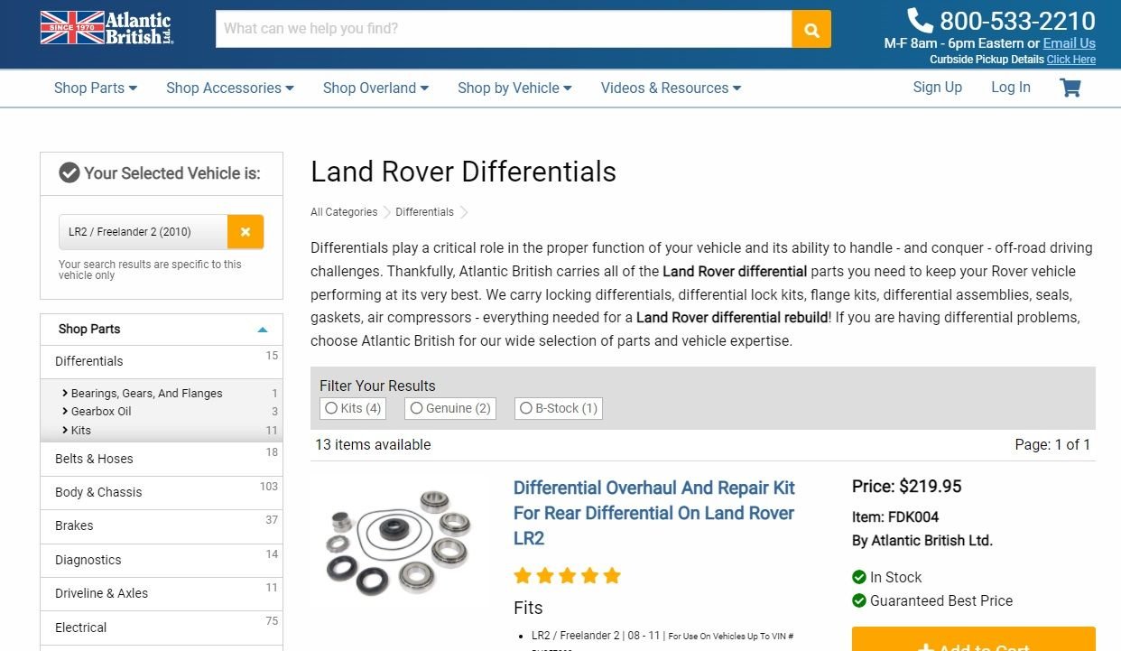

Volvo does not list internal parts for the rear diff. Only sold as a unit. As a work around I'm pretty sure the Land Rover LR2 uses the same Ford/Volvo/Land rover engine and rear diff as your car. These people at roverparts.com might can help with parts. Many others such as roverlandparts.com offer solutions also. - It appears that diff is not the most reliable

Thank you Hoonk, Good to have that exploded diagram and Price info. The wagon has 115,000 miles, and I’d rather take care of it now then when it gets louder. Next is getting that black coating off the wheels, I guess was an option, some day….
