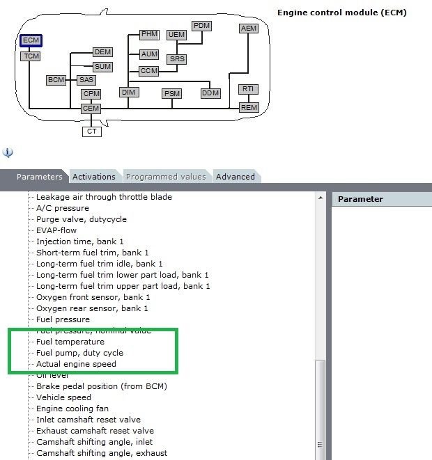

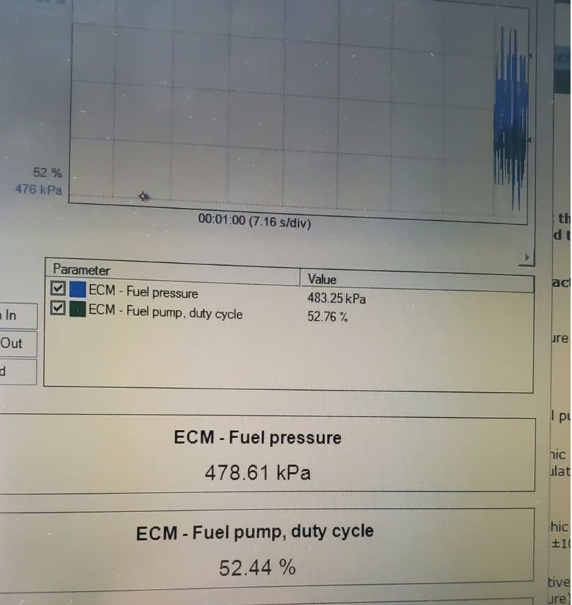

To determine if it's a fuel pump/system problem - you need to know the fuel pump duty cycle - I forget the spec but I think it should be ~35-40%. More than that is a problem. Foreign materials in the gas tank has been known to cause multiple fuel pump failures and could be a possibility in your case.
