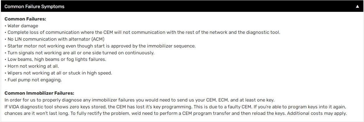

Common failures courtesy of xemodex

Joined: Nov 2022
I did indeed send the CEM to Xemodex who found it in good condition. Xemodex then suggested I send them the DEM. In all the forums and message boards I scoured looking for answers to the myriad codes, messages and wacky symptoms the car was exhibiting no one had mentioned the Haldex DEM. So I was reluctant to go that route but since I had few options other than sending the car to the wrecking yard, I sent in the DEM. Sure enough, it had water damage. Xemodex wanted $900 to fix it. The car has 273K miles on it and probably not worth $900. I had them send it back to me. In the meantime my Volvo guy said he had a couple of parts cars and he would see if he could swap out the damaged DEM for one that works. And, dang, if he didn't get it fixed. So that was the ghost in the machine. The Haldex DEM was bad. Hope this helps someone else.
