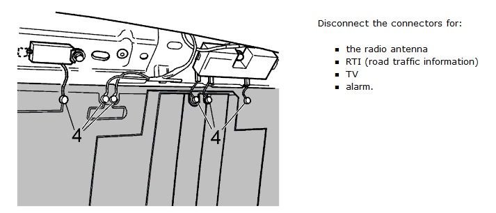

Can anyone please tell me where the radio aerial is
just bought the car ,tested 2 weeks ago and they did some jobs. Putting new struts on 5he tailgate
I assume if it’s in the roof they have damage something
radio was working when I tested it but now no sound. Is there something to mute it??
any help please
Old Jan 5, 2022 | 03:50 PM

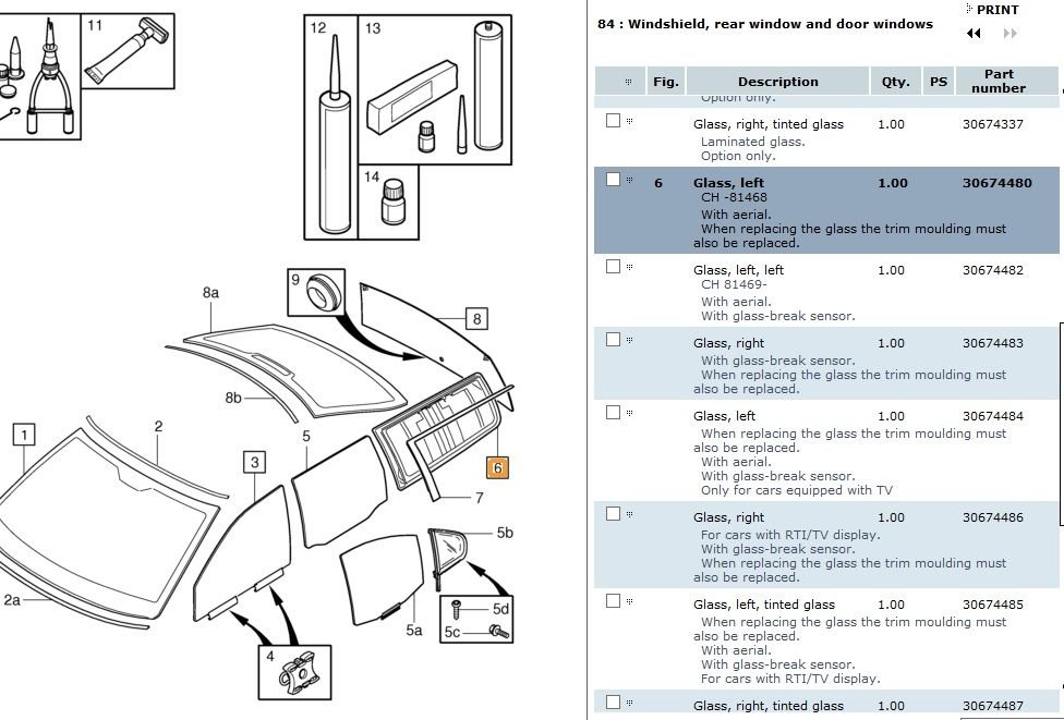

Antenna is in the LR window, electrical connectors are are the top. Does a CD play?
