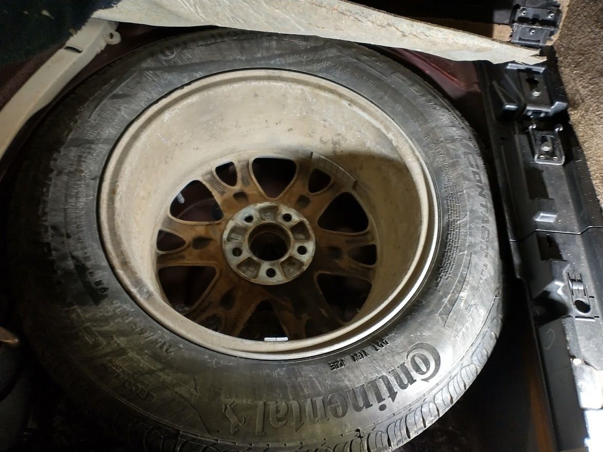

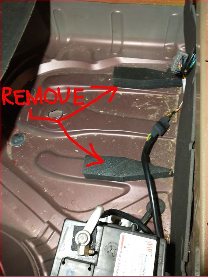

So the verdict is it will fit. Like someone said you just will not be able to put back the black tray as there will be no room for it.
I removed one of the wheels to use to test if it will fit into the spare wheel well. I also peeled off the 2 black hard foam pads glued towards the backside of the wheel well. Carefully placed the regular wheel into the well. Takes a little wiggling around bit eventually drops in. I glued 1/2"x12"x20" bubble wrap where the hard foam was. Also popped both trunk floor boards to open up the top side. See pics:
Remove foam pads
