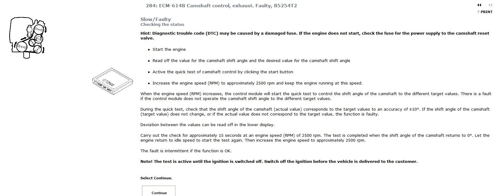

I have a issue with my 2006 Volvo xc70. I replaced my exhaust solenoid and hub. I am still getting a check engine light with EMC-614b coming on it. Any thoughts? I have the vida dice software and it shows a difference.
Old Feb 16, 2022 | 06:04 PM
[QUOTE=Ddtredy;508366]2006 Volvo xc70.EMC-614b have the vida dice software [QUOTE]
Have you looked at this page in VIDA? And the previous page listing possible causes? Is your cam timing exact? (I trust you used a holding/cam alignment tool to replace your gear)

I used a cam locking tool while performing this job.
The difference was -5.97
