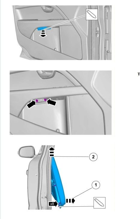

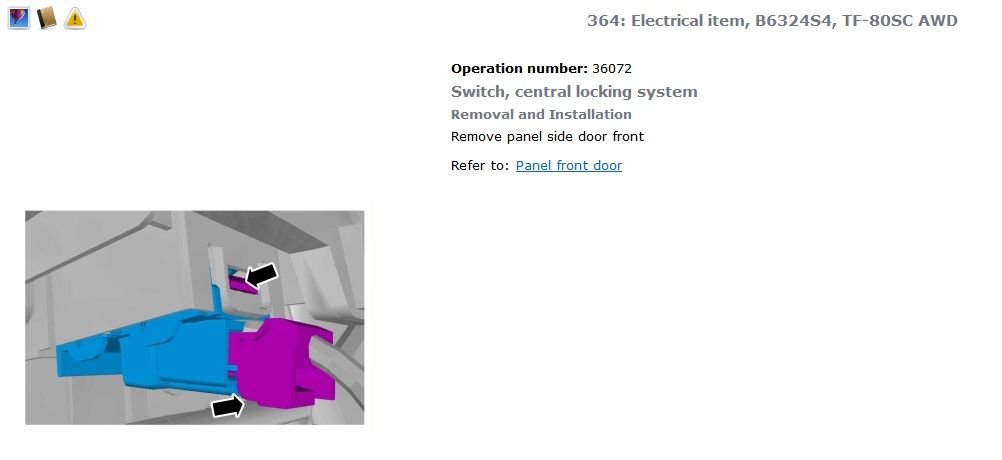

im trying to get access under the panel to fix the lock button. can i take it out the whole panel without door removel?
Old Sep 23, 2021 | 02:27 PM
No. You don't have to remove the door, but you must remove the door panel to get to the back of it to release the switch. Door panel is easy - after you get the black triangle off behind the mirror undo the 2 screws (3rd picture) and carefully pop the door panel loose from eight places, then undo wiring and inner latch cable.
