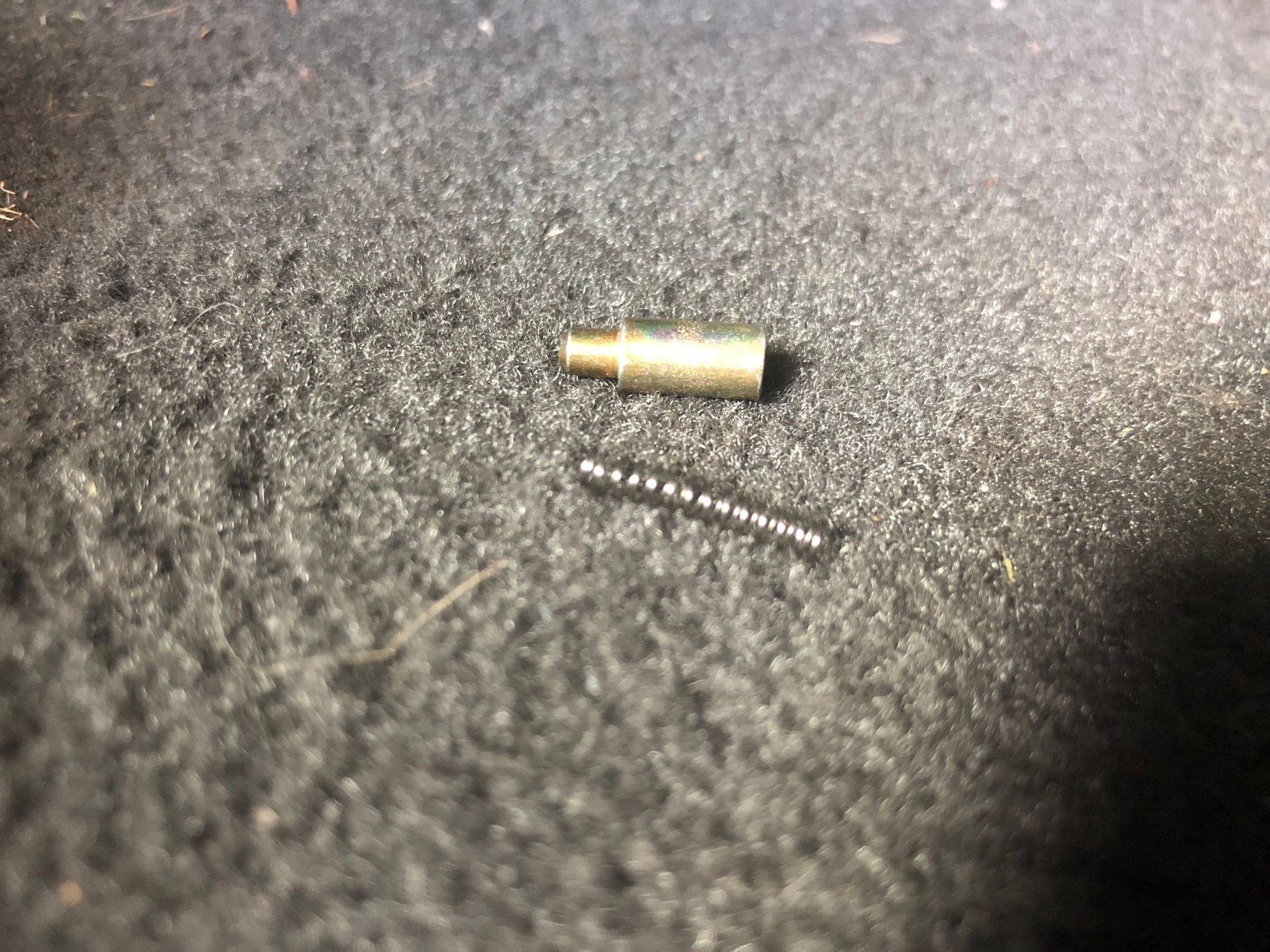

I was wondering if anyone knew where, in the process of removing the clockspring from the steering wheel, a brass detent and small spring would have came from. The parts were laying on the drivers floorboard after I had removed the airbag assy and then the clockspring. I did not notice them when I was done removing the old CS the other day, but I got into the car today to look for my flashlight and there they were laying on the carpet under the steering column.
Any help would be appreciated as I have inspected just about everything in the area and cannot find where a detent would be missing from.

The clockspring and airbag do not have any such parts that I have ever seen. The turn signal switch might have such a part. A pic would help.

Default Picture of spring and detent plunger
Spring and detent plunger that fell out during clock spring removal 2004 xc70

I'm totally unsure here. I've never seen those parts exposed.

Thanks for taking a look. I’ve scoured all exposed surfaces of the parts I have removed. New CS is here but I don’t really want to button it back up with the mystery unsolved.

I'm wondering if that is part of the ignition cylinder which is known to fail. At this point, I would put it back together and see what, if anything, is an issue.
Just be careful on those clocksprings. Do not get them out of alignment or you will be buying another.
