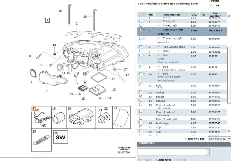

I have HID bulbs. The dealer said the wiring harness is frayed. My low beam drivers side goes on and off even though bulb has been replaced.
dealer said entire headlight assembly would need replacing to correct issue.

This parts page is for the turning HID headlamps - Volvo has a listing for the wiring harness #5 inside the headlamp, and you may need a #15 ballast also.
Tasca wants about $45 for the harness https://www.tascaparts.com/oem-parts...1353636?c=az0x Unfortunately ballasts are many hundred dollars.
You might want to get a second opinion
