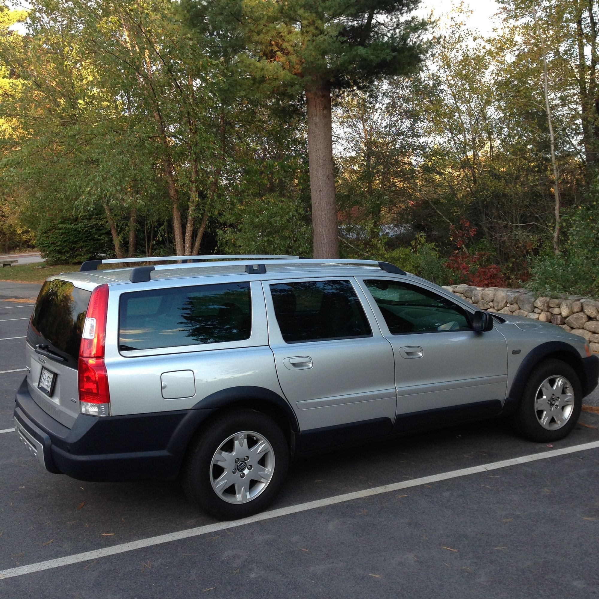

I have a 2006 XC70 and am interested in putting some aftermarket wheels on the car. I have not seen many 2001- 2007 XC70s with aftermarket wheels, so looking here for some suggestions. I currently have the original stock 16 inch wheels. I am looking for something similar to the the Volvo factory 2011-2015 machined charcoal wheels, or machined black gloss wheels that were available on the XC70s. I know those wheels will not fit on the 2006 model, therefore I am looking for something close in an aftermarket wheel. Something in 17 or 18 inch with correct fitment.

check out wheel-size.com to get a sense of what OEM wheel sizes are available for your year/model. Generally speaking from 1994 onward (not including the Nedscar gen 1 S40s) Volvo uses a 5x108 bolt pattern. There are two different center bores so you need to chose what's appropriate (your car has a 65.1 CB typical of the pre-2010 cars excepting the gen2 S40s which is why wheels from a 2011+ won't fit). For your 17s or 18s you'd want an 8" rim +- 1/2 inch with a 45 to 49mm offset (for an 8.5 go 45 for a 7.5 go 49). If you like the different OEM styles, check out the wheelcollision.com web site. They have a nice catalog with pictures and OEM names for you to consider when shopping. Just choose a rim by name and google - there's a aftermarket sellers who can source OEM style wheels at a fair price or you can search car-part.com to find OEM wheels used via a recycle yard

Thanks. I looked at what's available for OEM wheels for this year, and am looking for something different. I have resorted to the fact what I will need will be aftermarket. I will just need to match up the correct bolt patterns/offset for the wheels. I wish those [post] 2011 MACH/GREY ZEPHYRUS or MACHINE/GREY VALDER wheels would work.
