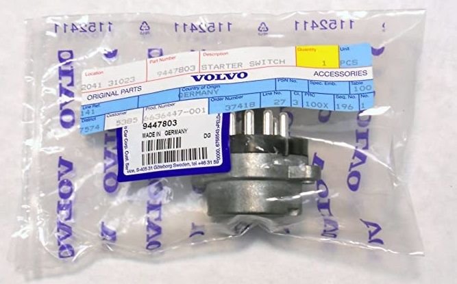

A 1996 has a plain key, no chip, no programming needed (or possible)
Your need to move/turn the key to get accessories to work is a common problem with the electrical portion of the ignition switch. Have replaced hundreds to solve that problem. Example of switch needed below. Note sure if that's the correct part number but that's what it looks like and is very simple to replace. (if you own a screwdriver and some torx drivers)
