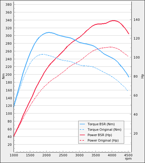

Ive been testing the car a bit and it can relatively easily hold 2000 rpm going up hill (100kmh) in top gear and it kicks off around 3000 (bit less than i mention above) and more so around 35 and very well 4000. Over 3 you start to feel the acceleration. I dont know how a diesel should handle but from the graphs i see it should have the most torque at 2000 and then it drops while the HP increase.
Im a bit green on this but if im thinking right the best power would be where the Torque/HP intersects? Then the V50 would pull the best about 3000 correct? Ive been under impression that torque means acceleration and thats peaking about 2000 which is why im a bit unsure.
