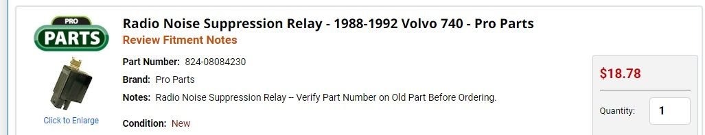

There is a fuel system relay in the fuse box (square black or rectangular white depending on fuel system) and most have a noise suppression relay under the hood. The noise suppression relay powers the injectors on some cars - moving the electrical noise they create away from the radio. Noise suppression relay might be mounted near the RF corner of the car.
Sometimes the wiring is damaged to the underhood relay - this guy has replacement parts
https://www.prancingmoose.com/
