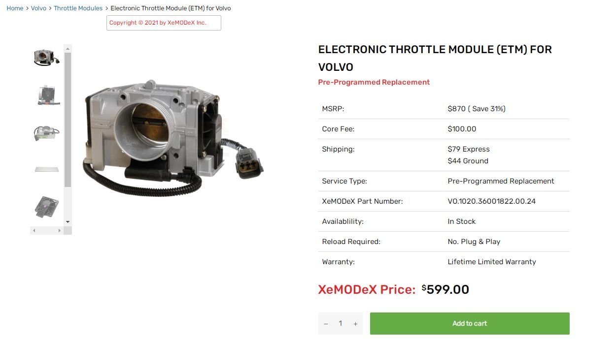

When was your known to fail often Magnetti Marelli (sp) throttle housing replaced? And save your sea foam money for something the car really needs.
Old Sep 15, 2021 | 03:30 PM
Doubleu3's Avatar
Joined: Mar 2021
Default Thanks
I don't know. This is the first time I've ever heard of it. You've been amazingly helpful.
Old Sep 15, 2021 | 03:55 PM
I think that was the first part that xemodex was rebuilding - they (and others) have re-engineered the potentiometers (sp) in them to be a non contact type - The module is coded to the VIN number of the car. A new one requires a software download to make it work. Xemodex preprograms theirs if you wish or others have been able to get used ones to work if from the right year, correct sticker on it, moon is in the right phase and you clasp your hands just right when you try to restart the car. Don't choke on the price - those modules were used from 99-02, and before xemodex came along the only option was at least $1300 for a new one with programming. Replaced at least 20 of those that way, using new parts until reman was a choice.

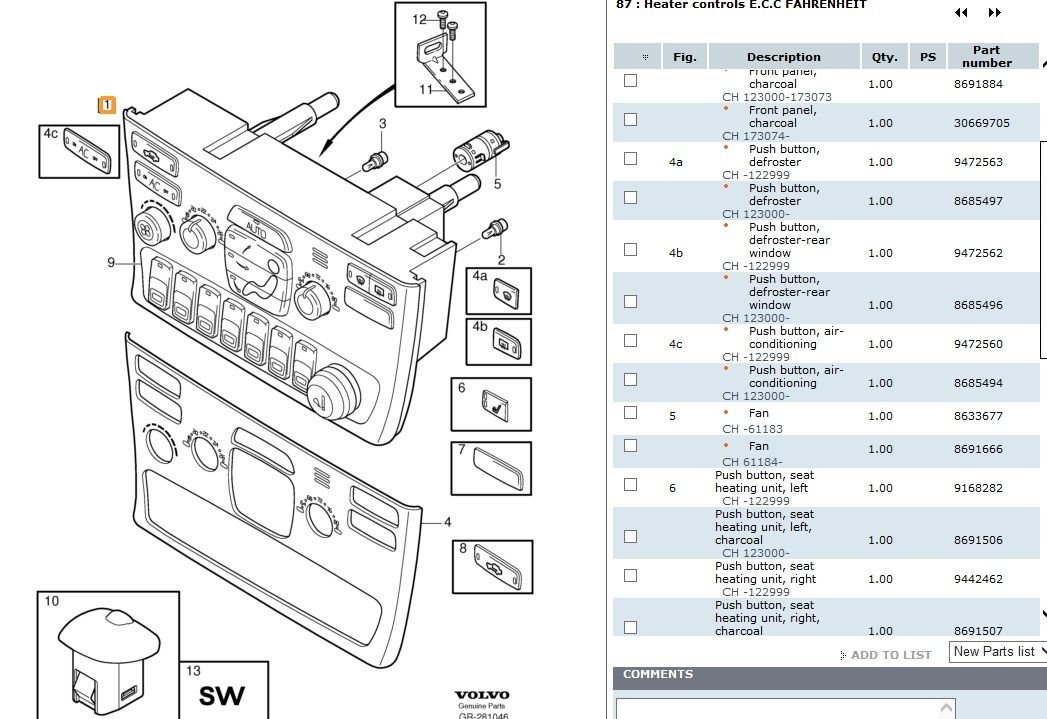

Also, when any car door is opened, what sounds like a small fan noise is coming from the lower dash. and is frustratingly difficult to locate.
There is a small fan that pulls air across the temp sensor for the interior of the car. It's located behind the little slots above the passenger temperature setting **** on the CCM. I'm certain by now that is full of dust - don't try to remove the dust bunny by mechanical force - you will damage the temp sensor and that destroys the CCM. You can't purchase a sensor by itself . A vacuum or gentle blast of air might remove the bunny. Removing and cleaning the fan/motor might be needed if it's your noise - take the CCM out to get to it. It's #5 in the diagram.
