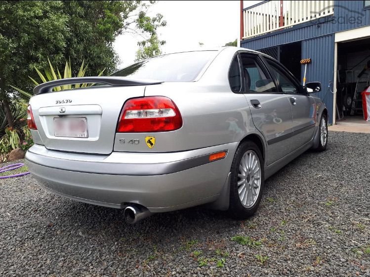

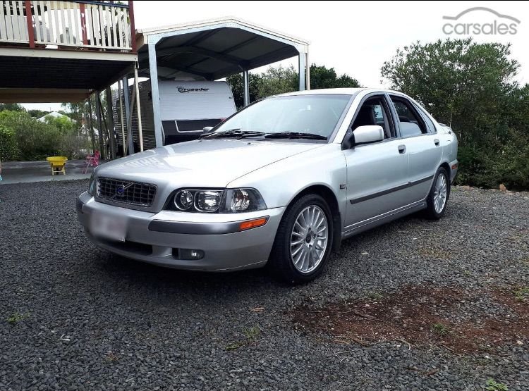

I bought a 2002 (2003?) Volvo s40 in a private sale. It needs repairs, and I’m not sure it’s going to be worth it for me, but the car is very nice considering its age. I'm wondering if I should onsell it, or whether anyone can recommend a mechanic to fix it.
I paid $1000 for it, but I’ve heard it might be able to get most of this back for the parts depending on who I sell it to. I had one repair quote of at least $3K (to fix exhaust and oil leaks, and some minor issues like indicator bulbs), but I’m thinking of getting a second opinion because that mechanic would have had to send it offsite due to lack of resources to fix it and as a result that quote is likely higher than it could be.

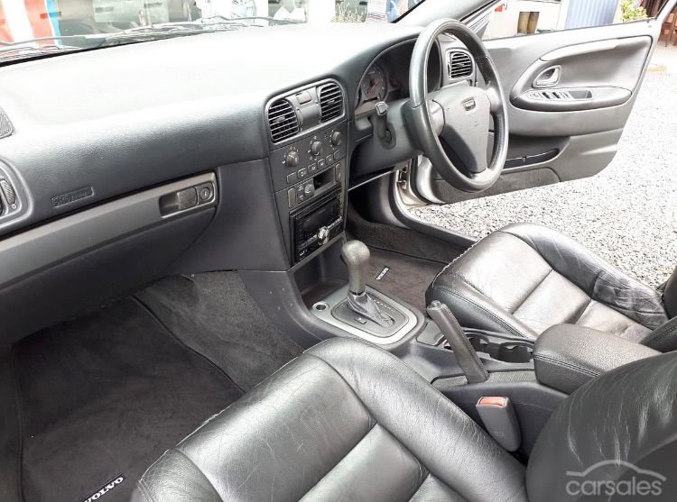

Seems a shame to wreck it, because there’s barely a scratch on it, the interior is leather and very nice, and there’s a new stereo, battery and tyres.
