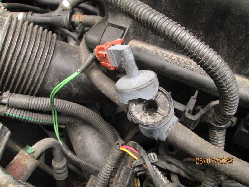

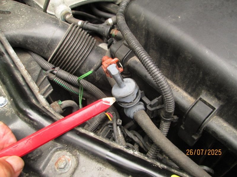

Hi, I was changing the air filter in my 2004 XC70 and this part pretty much fell apart when I touched it. What is it ? It seems to be in vacuum or PCV system, but I can't find it on any diagrams. Any chance taping it shut would fix it? Thanks in advance.

Brake vacuum pump switch. Usually when they break the vacuum pump runs all the time, overheats and seizes up. Won't do you any good to replace the switch if the pump is seized! (make sure your vacuum pump still works BEFORE replacing the broken switch) There are a few variations so make sure the one you order fits your car. And there are aftermarket switches available for about half the price.
