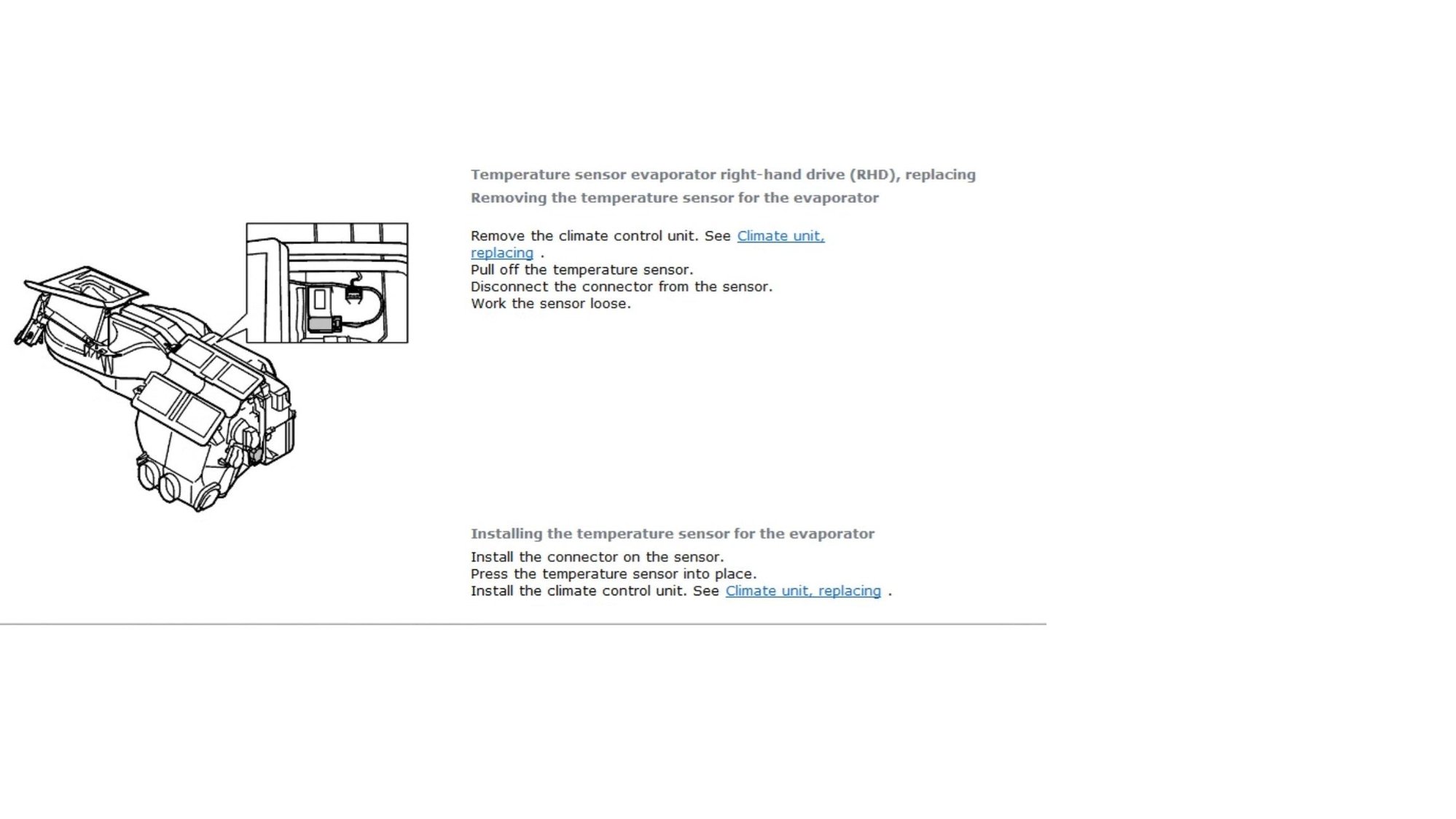

Hello! I need help please locating the evaporator temp sensor on Right hand drive Xc90 2004,
I spent 2 days already with no luck...
part number 30665118
I did check all schematics in the web but could not find it....
thank you very much?
Old Oct 2, 2024 | 10:09 AM
LHD cars the sensor is easy to get to - RHD cars Volvo wants you to remove the climate unit to get to it!
